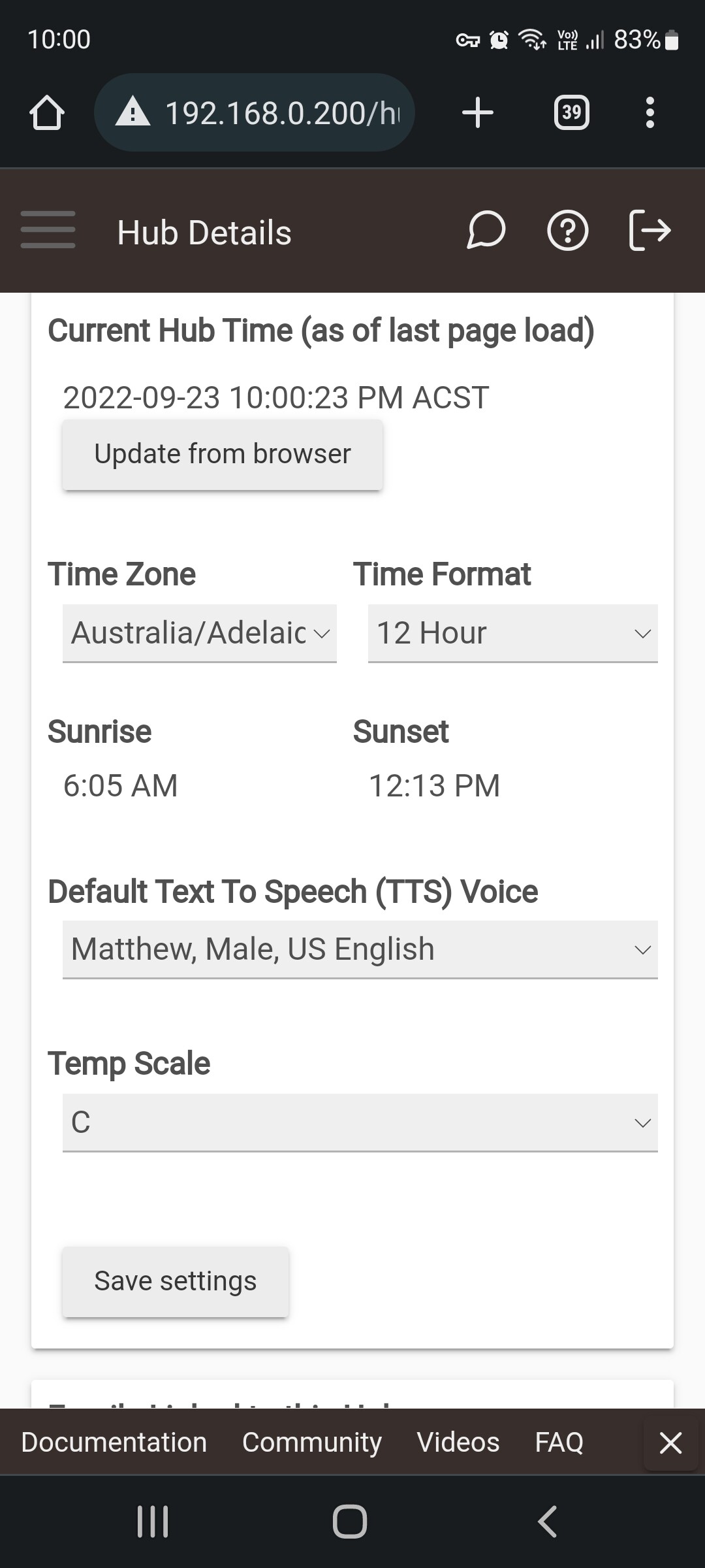

As of today both my hubs C5 and C7 are showing Sunset is 12:13pm it should be 6:13pm so this mean all my rules with a Sunset trigger ran 13min after noon. The sunrise time is correct.
It's been working correctly for years and just started today.
Anyone else seeing this?
I updated the hubs to the latest version after seeing this but it's still the same post update.
My longitude and latitude are correct.
-34.920000, 138.510000 (Note I've modified this slightly for security)
My time zone is Australia/Adelaide.

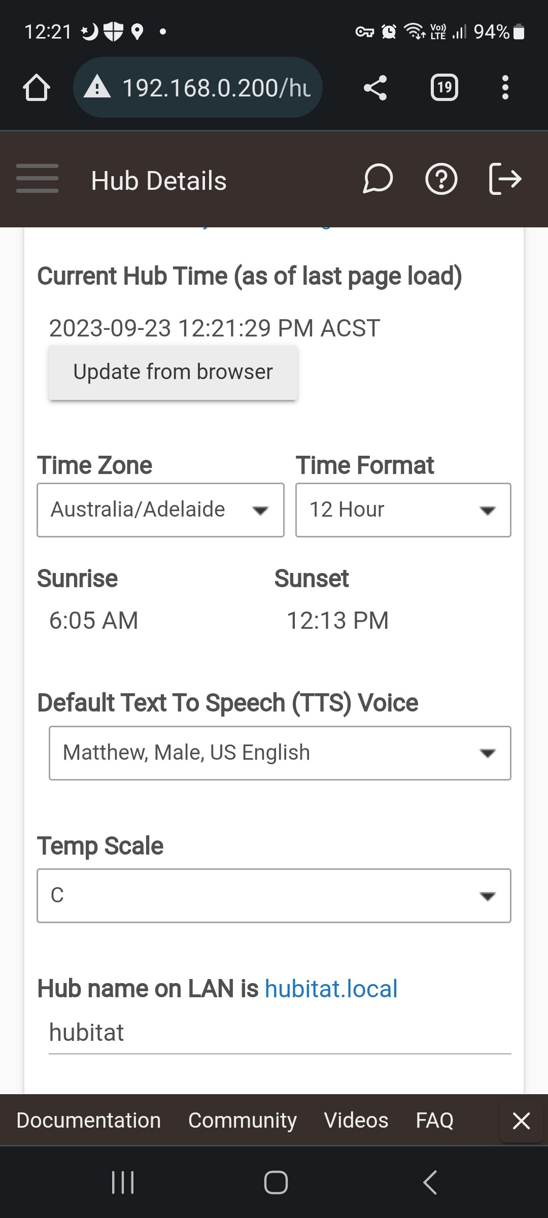

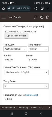

This has just happened again, is there a bug in the data for 22/23 of September?
It's exactly 1 year since this last happened!

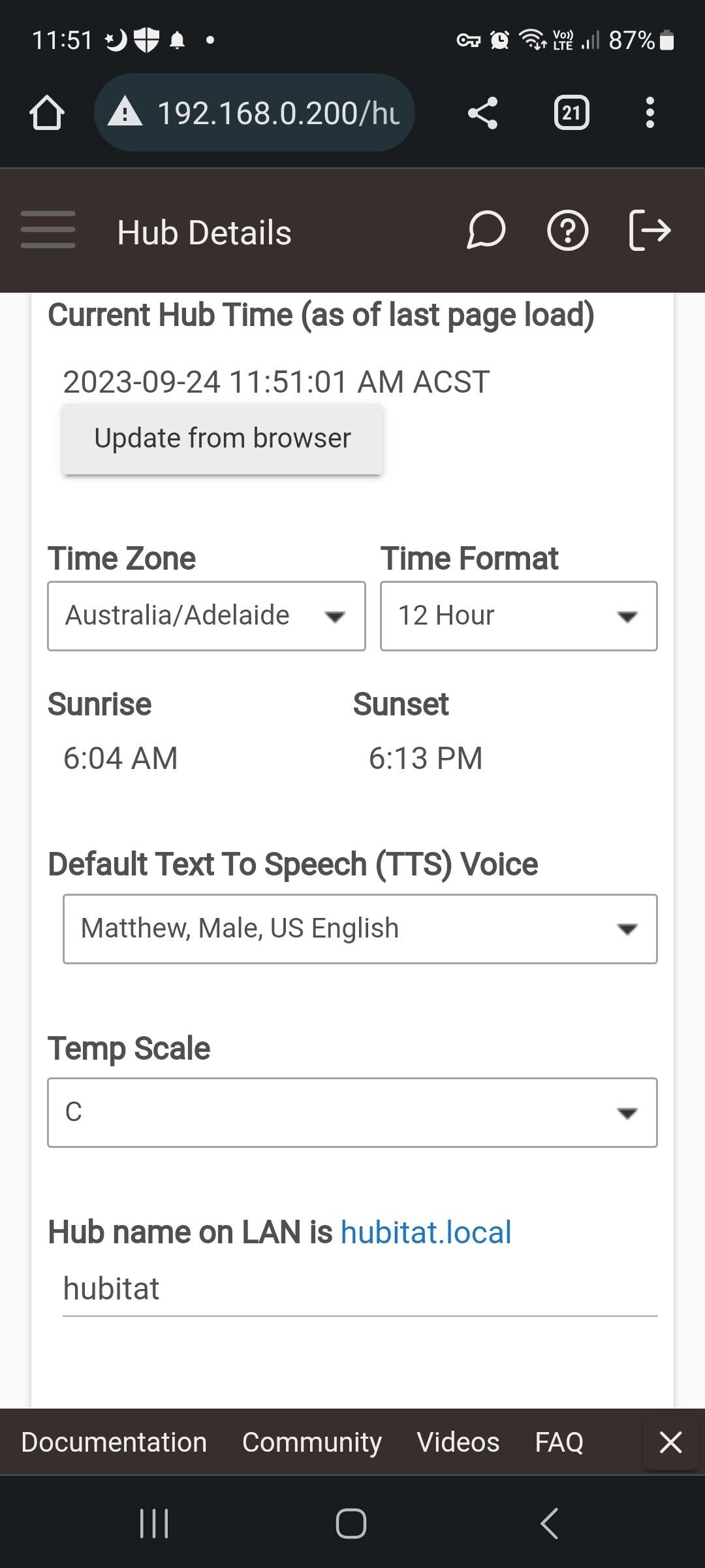

Hi Again,
Just check and without doing anything today the Sunset time is correct.
So it looks like there's been an error with the Sunset data for the 23 of September the last 2 years.
