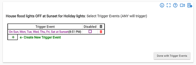

I have several rules that use Sunrise or Sunset. For some reason this rule thinks Sunset is at 8:51 PM. Sunset today is at 4:57 PM. Any ideas why this is happening?

No, but recreating the rule resolved this. This rule has a required expression. 11/25 (yesterday) to 1/10.
Is it possible that it didn't/doesn't update Sunrise/Sunset after 1/10?
Possibly; I have not tested this and don't know when it updates the display. An exact (no offset) or sunset trigger is typically an event subscription, not a scheduled job, however, so it shouldn't have affected actual execution.
It didn't work yesterday, 11/25 or today so I'm assuming it was not going to work. Well, I'll rephrase it. It worked at 8:51 yesterday, and it didn't work at 4:57 today so I'm assuming....
EDIT: I went through a few of my other Sunrise/Sunset rules and they were set to trigger at the correct Sunset (4:57), so it seems it was specific to this rule.... :man_shrugging:
