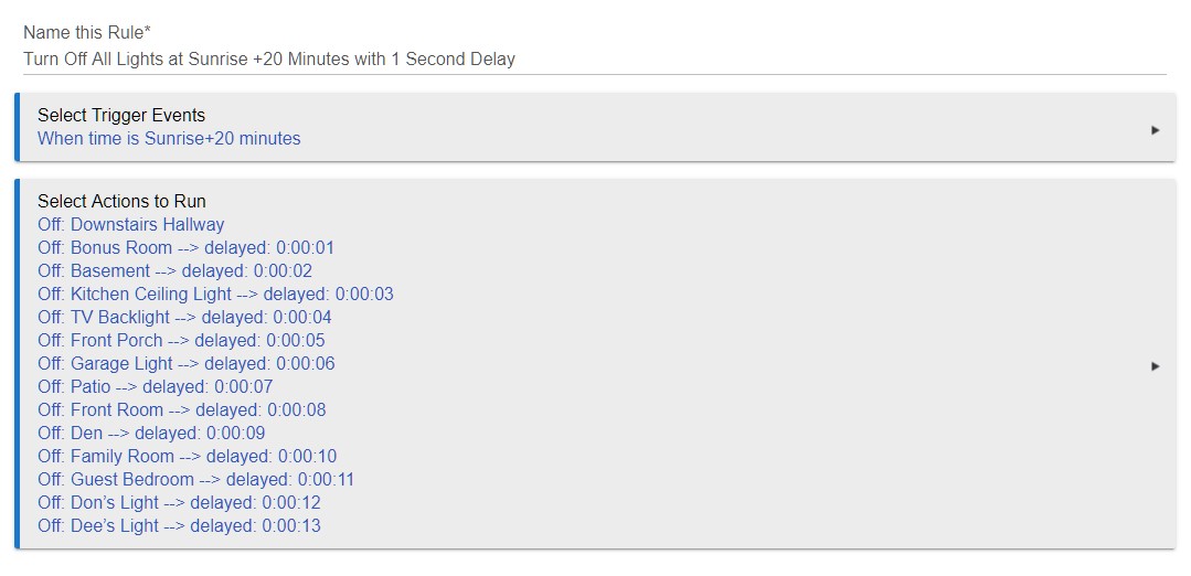

The rule is trivial, simply turning off lights and devices around the house at Sunrise +20 minutes, with a 1-second delay between actions, one device per action.

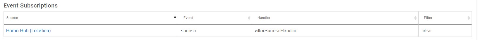

The rule shows the Sunrise event is properly subscribed. My time zone is correct.

Hmm. I'm seeg a "No scheduled jobs are set" indication at the bottom of the Rule after clicking on the Gear icon.
All my other Sunrise/Sunset rules show a single pending job scheduled.
I tried a minor edit to the rule and re-saving, but still no scheduled event showing.
I also copied the rule, but still no event scheduled on the copy.

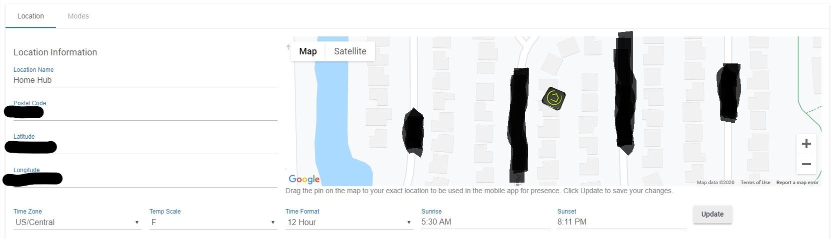

go to hub settings-> locations and modes. Validate your location and sunrise/sunset times. Mine has gotten corrupted once or twice
I checked this, moved my latitude by a degree, saved, moved it back and saved again. However, the information and sunrise/sunset times were correct before I did this.
We'll see what happens tomorrow.

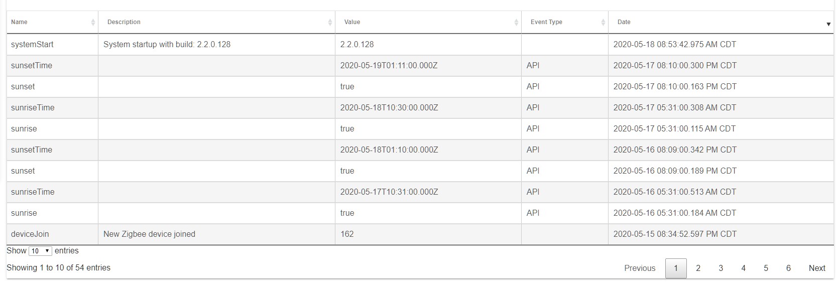

Sunrise showed up in System Events this morning at the correct time All my actions triggered normally.
I shut off two rules that were doing frequent polls on 6 problem devices last night after finding an alternate solution. The load on the HE might have been a factor in the missed Sunrise System Event.
