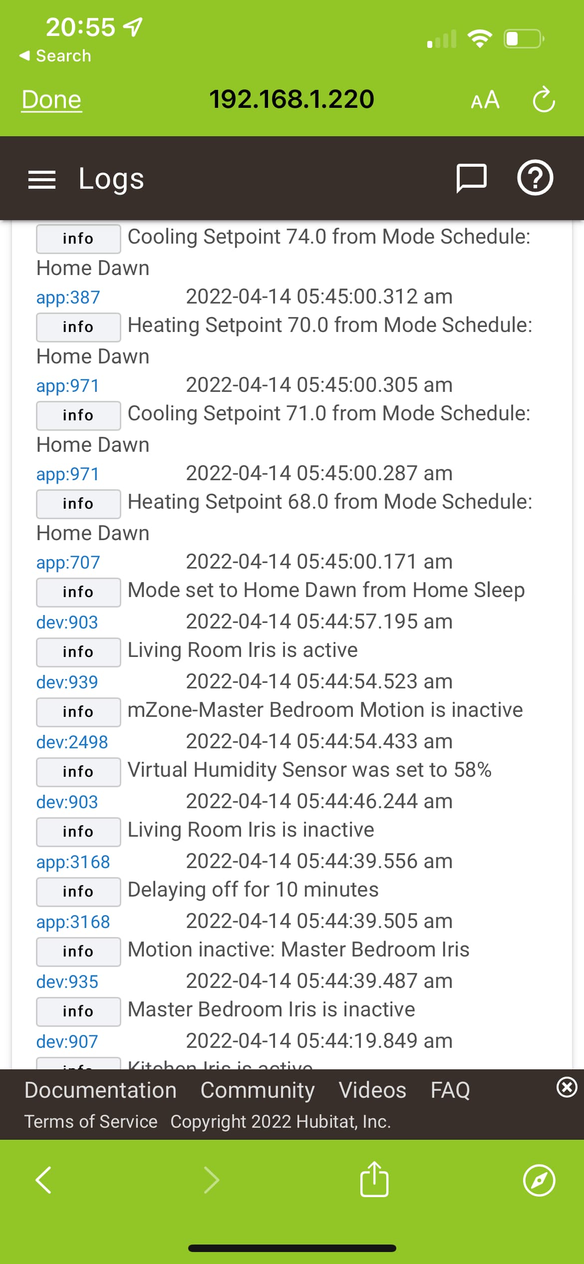

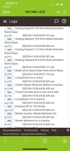

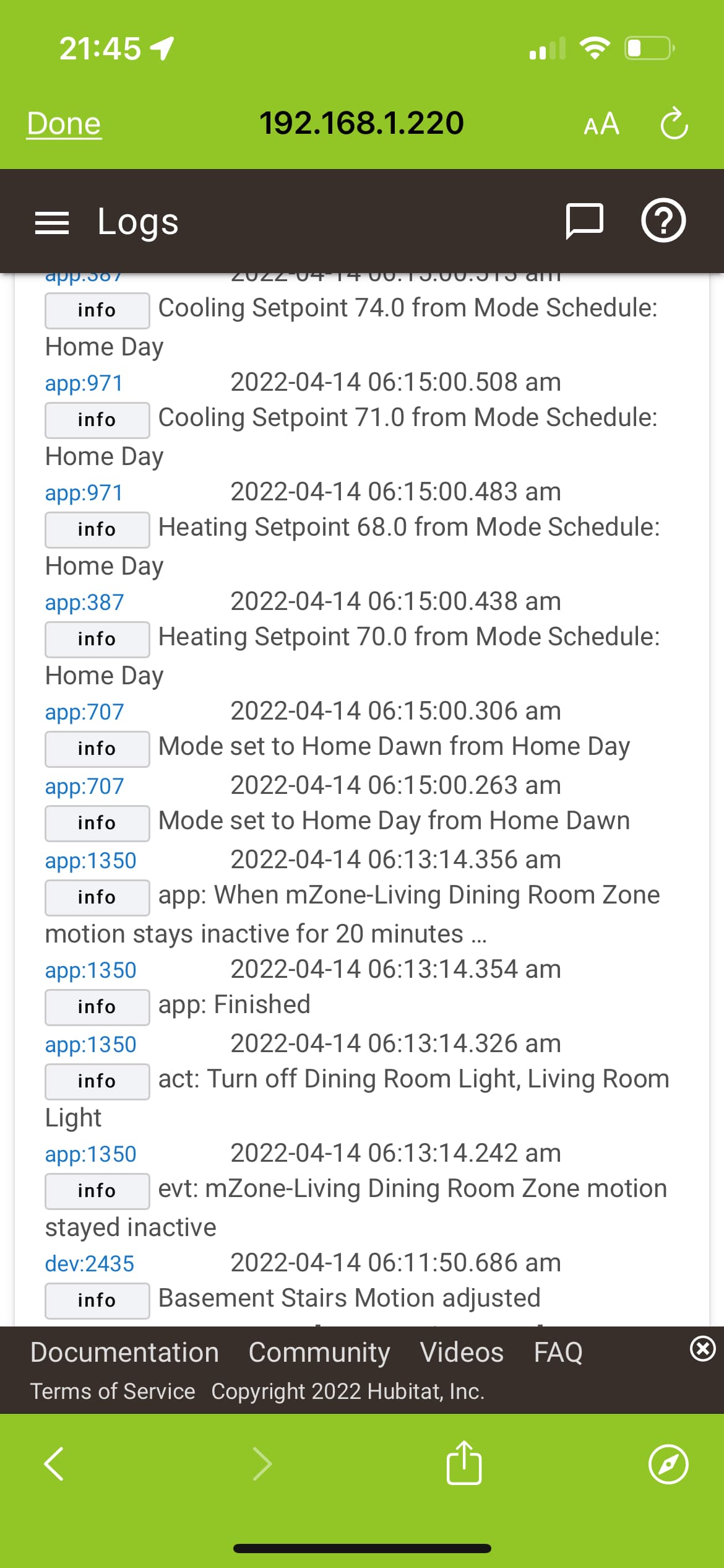

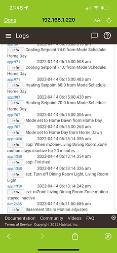

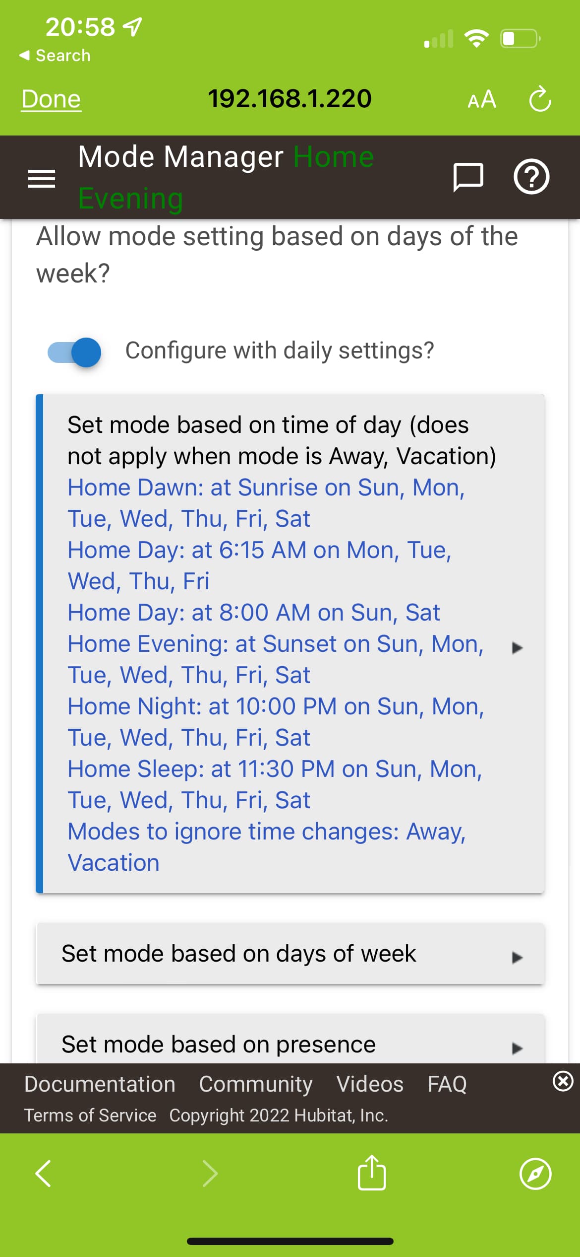

Maybe it has something to do with my mode change times. I had Mode Dawn set to Sunrise -30. My Mode Day begins at 6:15. This is what the logs say. I took the -30 out yesterday and the modes changed properly now.
