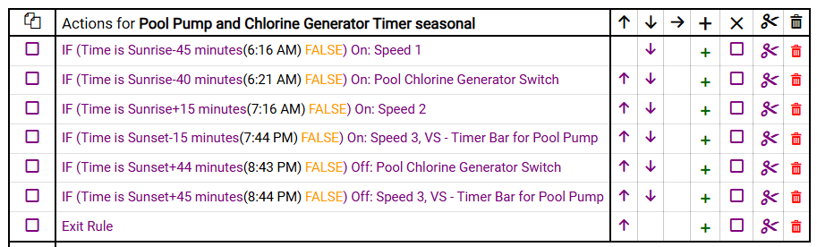

I noticed that Hubitat already computes those times if I enable "Display current times" in rule machine. So in the screenshot below, I would take 8:44pm minus 6:16am to come up with a total duration the pool pump was on. So that's pretty much it. I'd like the duration time, and in 00:00:00 format.

You don't specify a trigger that will make those actions even start. Assuming that the trigger is Sunrise-45 minutes, the first IF action might turn on the pump, but for sure all of the other IF actions will register as false and the rule will end.
What you might do is look for one of the scheduling apps on the forum that let you turn things (switches, pumps, etc.) ON or OFF as specified times (absolute or relative to sun set/rise).

This isn't the rule I'm trying to create. It's being used as an example to show that Hubitat already calculates sunset/sunrise +/- times. Disregard the IF statements and just look at the times being shown. If I could grab those times instead of trying to calculate them with a rule, things would be simpler. I don't think I can though.
OK, got that part. But I'm still not clear on what you are trying to do, just figure out total time duration from your start and stop times, or calculate a set of absolute times based on a relative time plus/minus an offset, or something else.

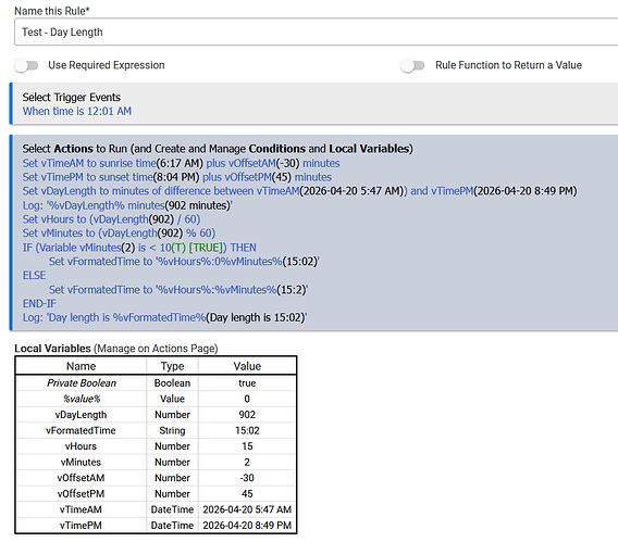

Note that you can do something like this, where vTimeStop is a DateTime variable, and vTimeStopOffset is a number variable, if you just want to get the absolute time based on an offset to sun set/rise:
Set vTimeStop to sunset time(8:04 PM) plus vTimeStopOffset(30) minutes

Success.
What started out as an idea a week ago has turned into a completed product. A countdown timer based on the changing difference between sunrise and sunset times instead of a static time period.
The remaining time is counted down on the right side and a colored bar moves across as the countdown progresses.
I had to copy one of the local variables to a hub variable and create a connector so it would be attached to a device. I could then send that to Home Assistant via Maker API which then could be put on a timer bar card on my dashboard. The rule runs every morning at 6am.
