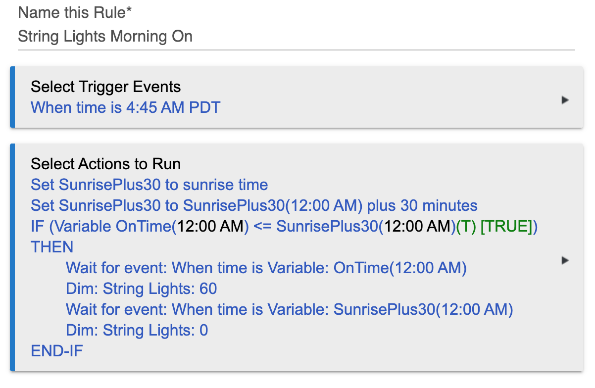

I can read this and understand all of it, it's just translating by using the Rule Machine that's got me hung up. I NEVER :joy: would have figured this out on my own. And I'm not sure I have it right as when I created the variables it asked for a time and those times show in my rule. Would they be overwritten when the rule is run?
Is this correct? I may try the idea from @j715 as well. That seems like a super simple soln too. Tho I really need to get better at the Rule Machine.

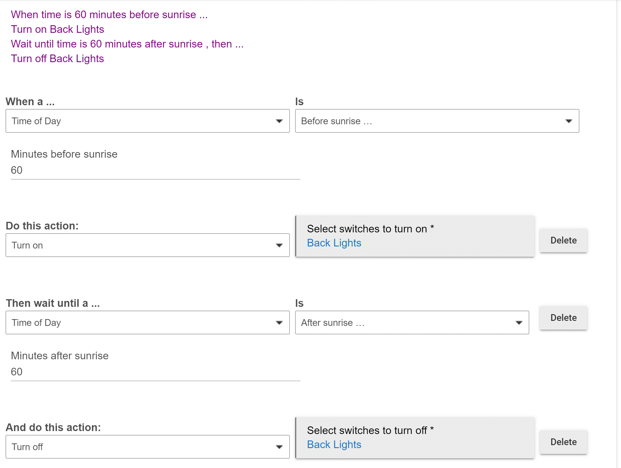

I just created this using Basic Rules. It should do what you want.
SunrisePlus30 will be overwritten every time the rule runs. OnTime should be set from the beginning to 6:15 AM. In the rule there is a Run Action button. Click on that button and you'll see SunrisePlus30 get updated.
