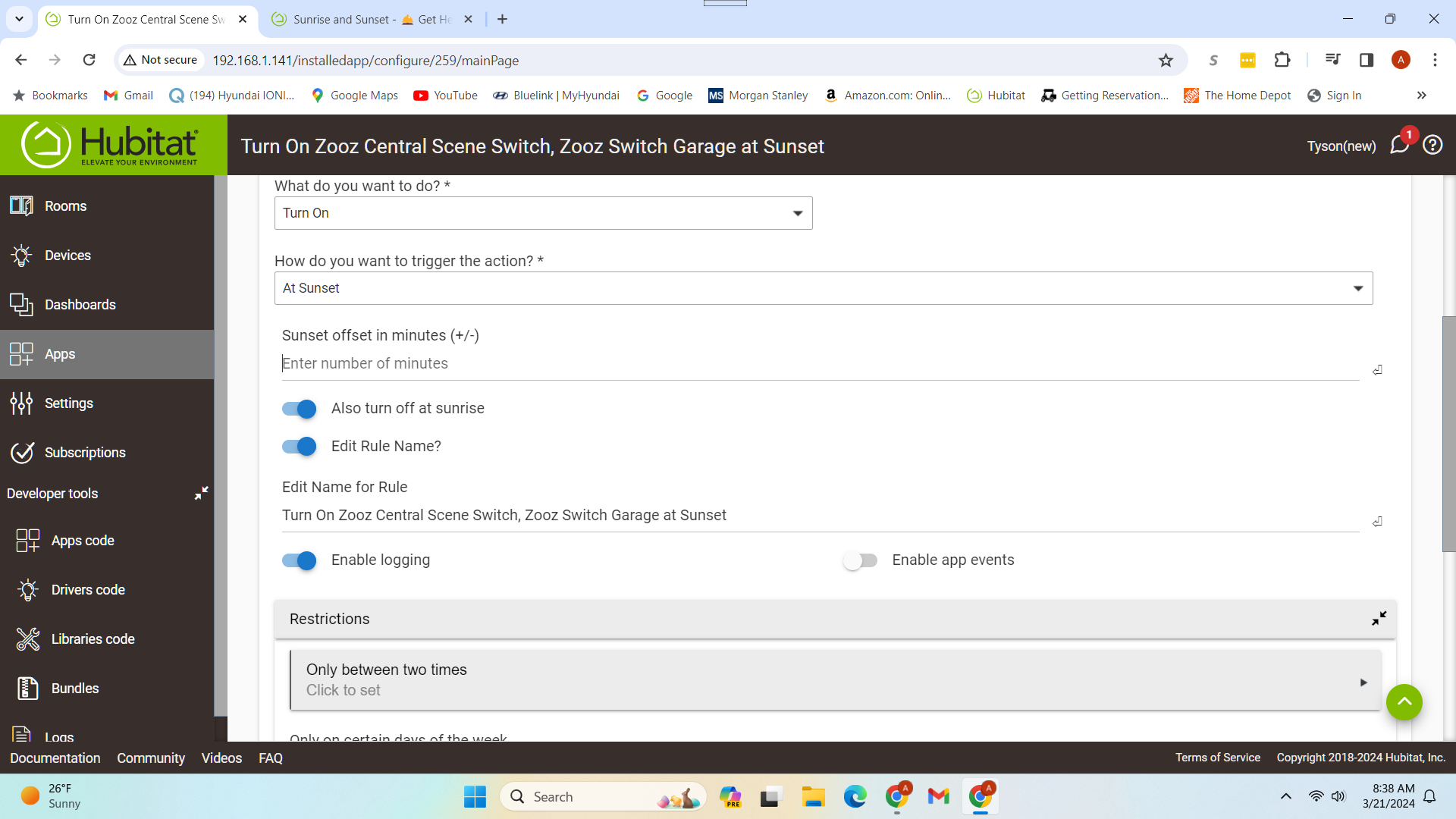

I am using sunrise/sunset for control of my outside lights which has been working fine for years. They now come on at sunset but go off 2 hours before sunrise. I have rebooted hub but no change.
I looked in settings and sunrise/sunset are correct.

  • Provide a screenshot of the setup of the automation

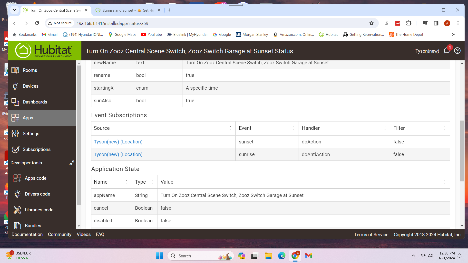

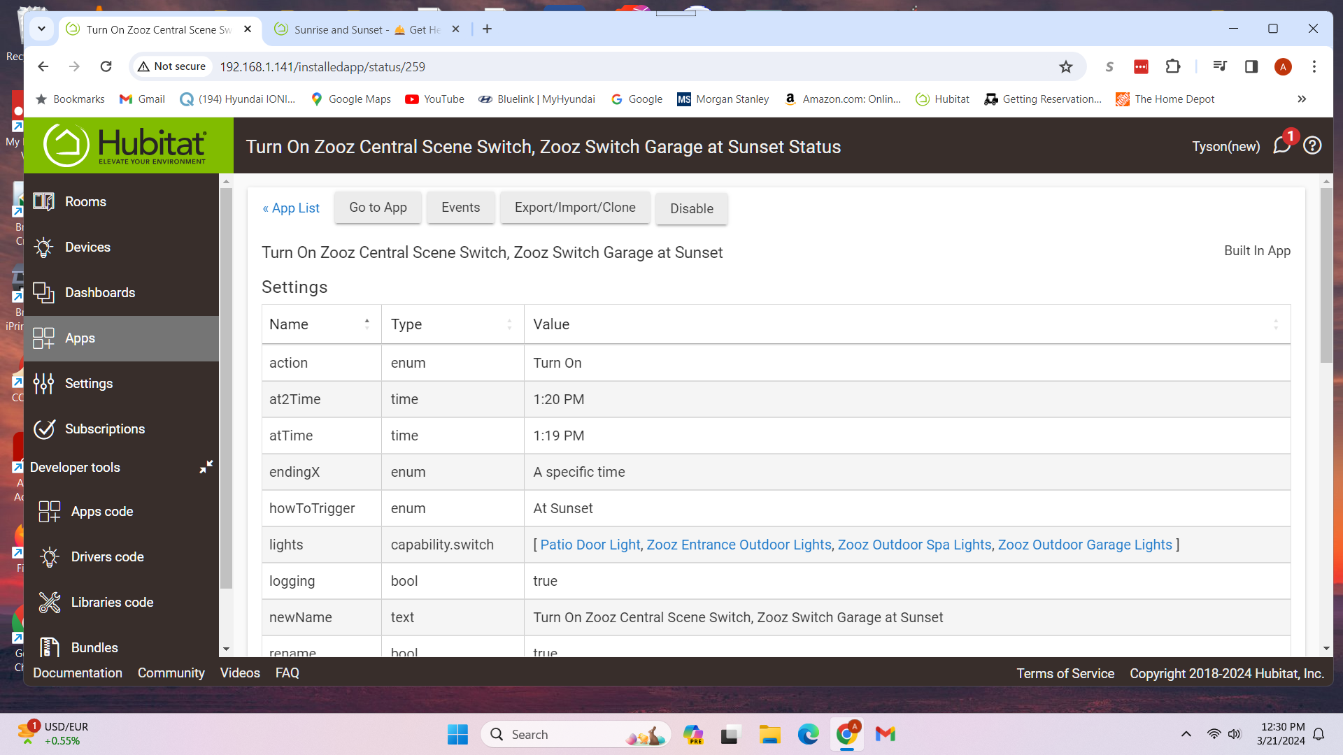

Also if you click on the gear icon in the upper right of your simple automation rule (not visible in the screenshot), that will take you to another page with additional info about what’s running under the hood of this rule.
Sharing a screenshot of that page (all of it) would also provide useful info for troubleshooting.

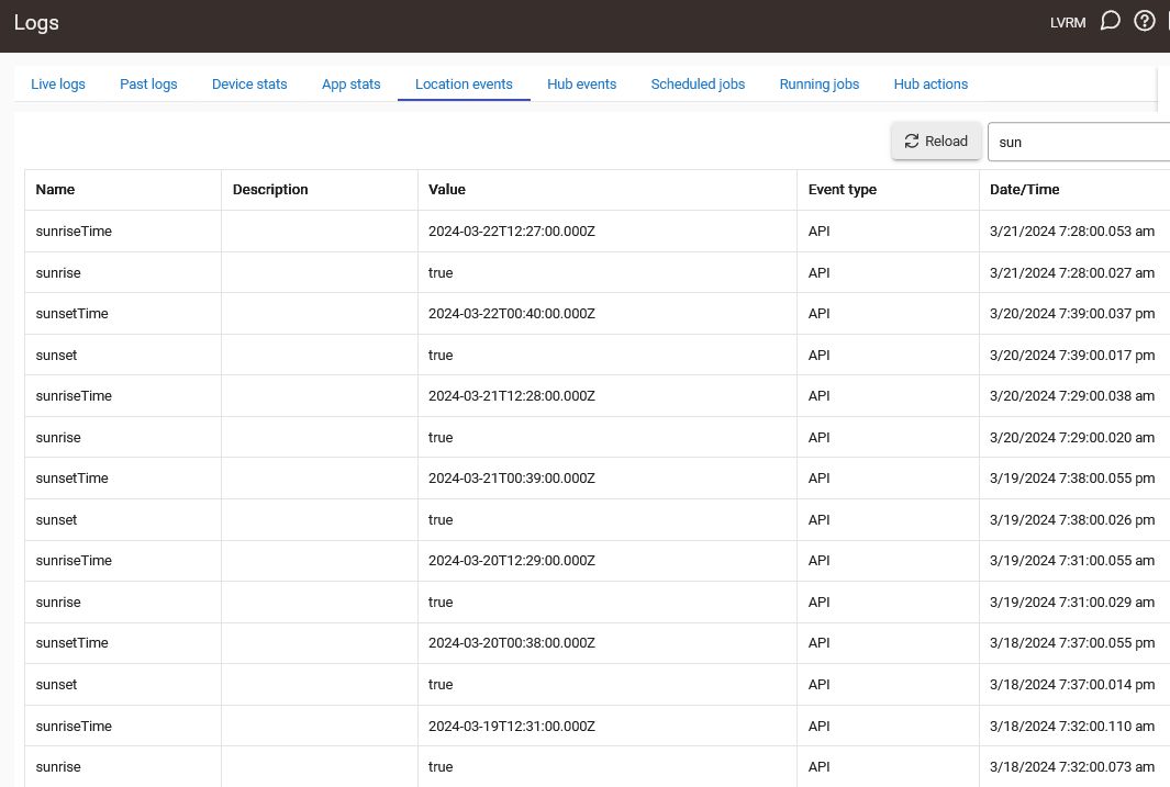

Go to the logs section and then select the location events tab at the top. That will tell you when the hub thinks sunrise and sunset are at least:

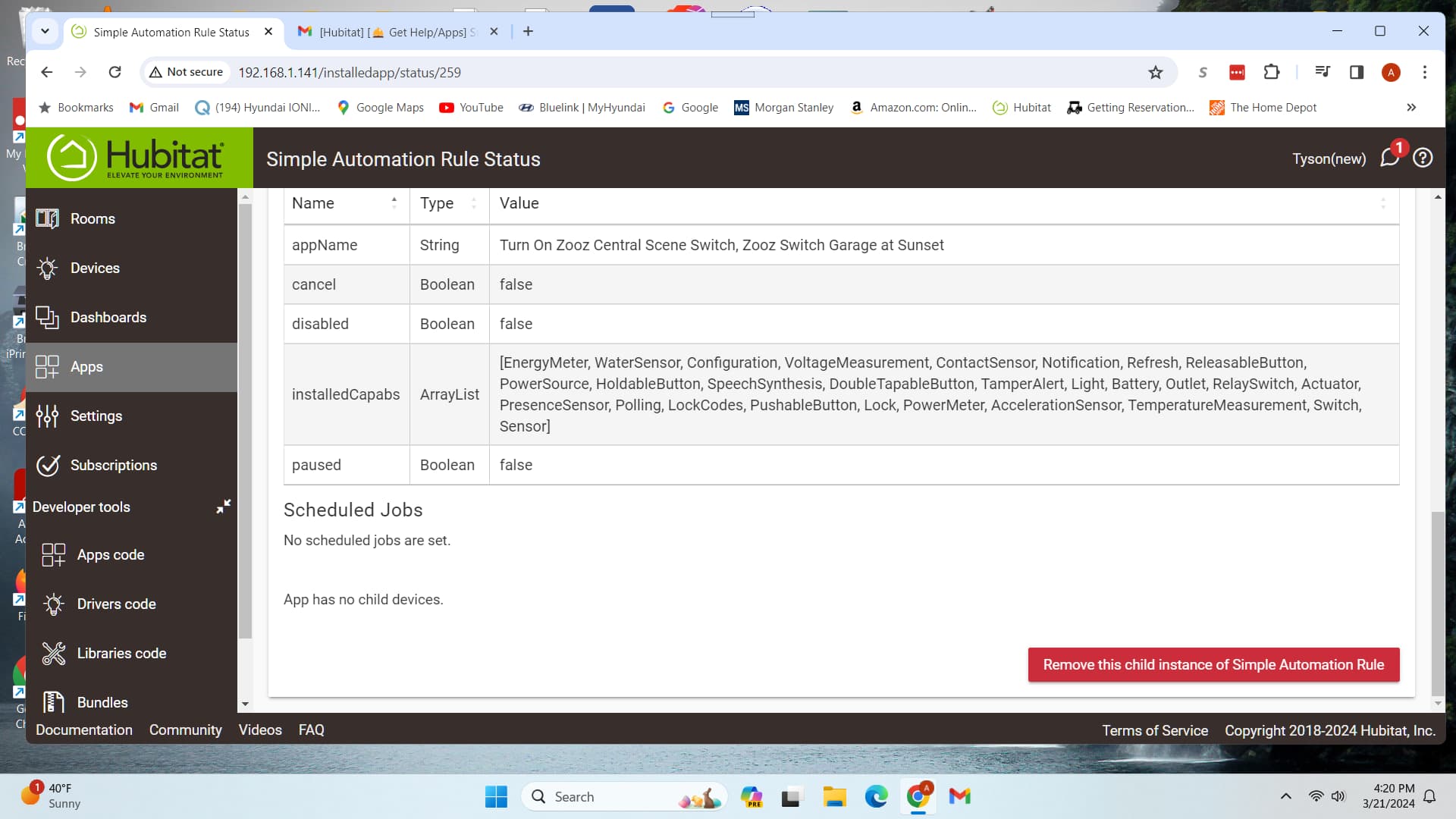

What about the bottom of that page? There should be a section for “scheduled jobs.”
There are no scheduled jobs. Should there be?
I would have thought so but just created a test rule and mine looks the same. The rule subscribes to sunrise and sunset events (as it should), and there are no scheduled jobs.
If you haven’t already, you could try clicking “done” on the rule’s main configuration page. That should get it to resubscribe to the sunrise and sunset events.
If you have clicked “done” at least once since this issue popped up, it’s such a simple rule that I’d suggest just removing it and creating a new one to see if the problem persists.
