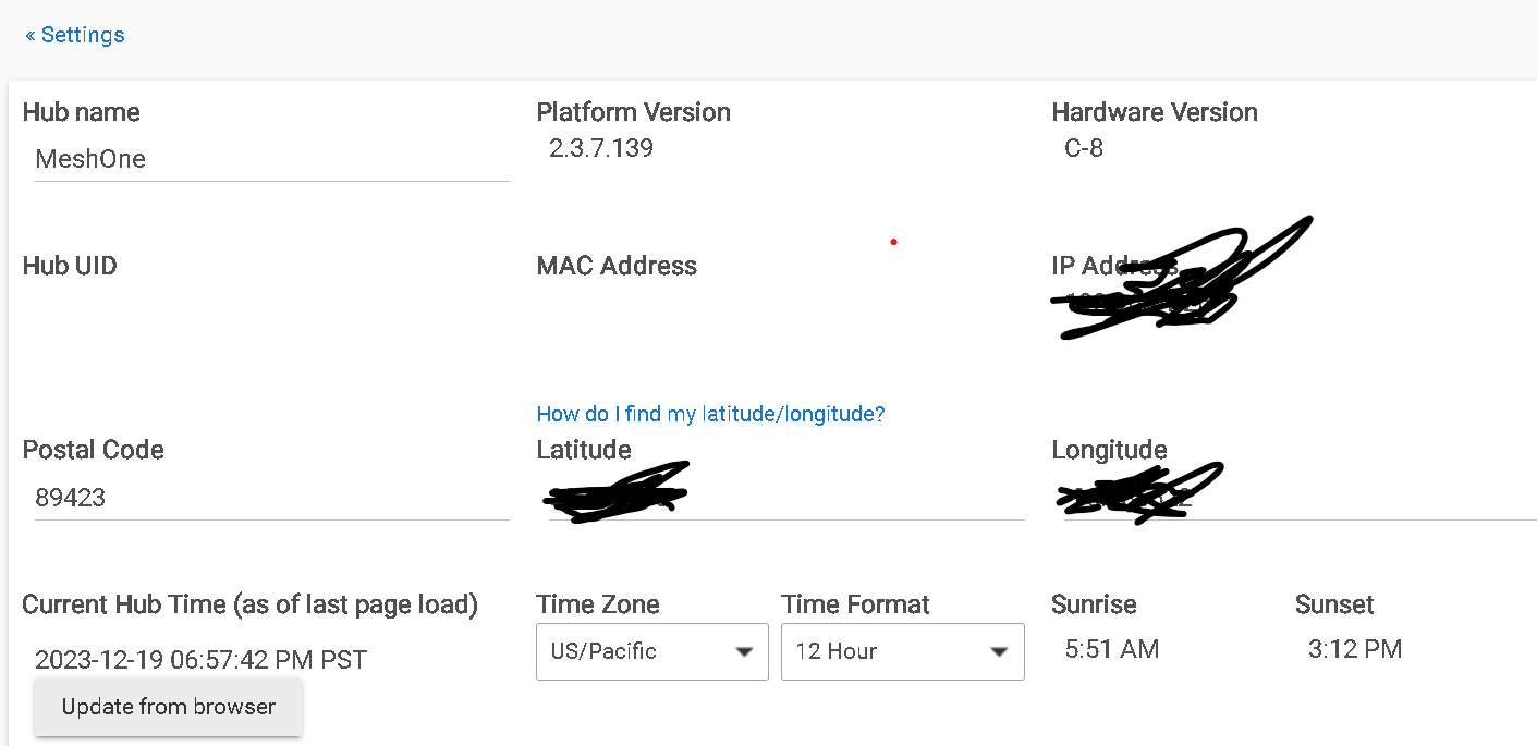

Sunrise and Sunset has never updated on two different hubs
I have checked settings and updated hubs. I migrated to the to the C8 and have always had the same Sunset Sunrise on both hubs. It has NEVER changed. Wondering if problem migrated from the old hub to the new.

Could you please screenshot your Hub Details page from the Settings tab? Either redact or hide your hub ID and MAC address, and any email or things like that. There are hide buttons for a couple settings you can use to make it easy.

Are the Lat/Long correct, at least in the right vicinity of where you live? I think that might be what is used for the sunrise and sunset.
Yes, I checked it with the tool.
Only thing I can think of would be to clear the zip and lat/long, save. Maybe reboot for good measure. Then go back in and set the Zip, then lat/long again. Maybe change the time zone to something else, save, then back again. Just in case something is stuck with an old/bad setting cached somewhere. Otherwise it looks like it should be working.

Change and reboot worked. Thanks so much. Merry Christmas!
