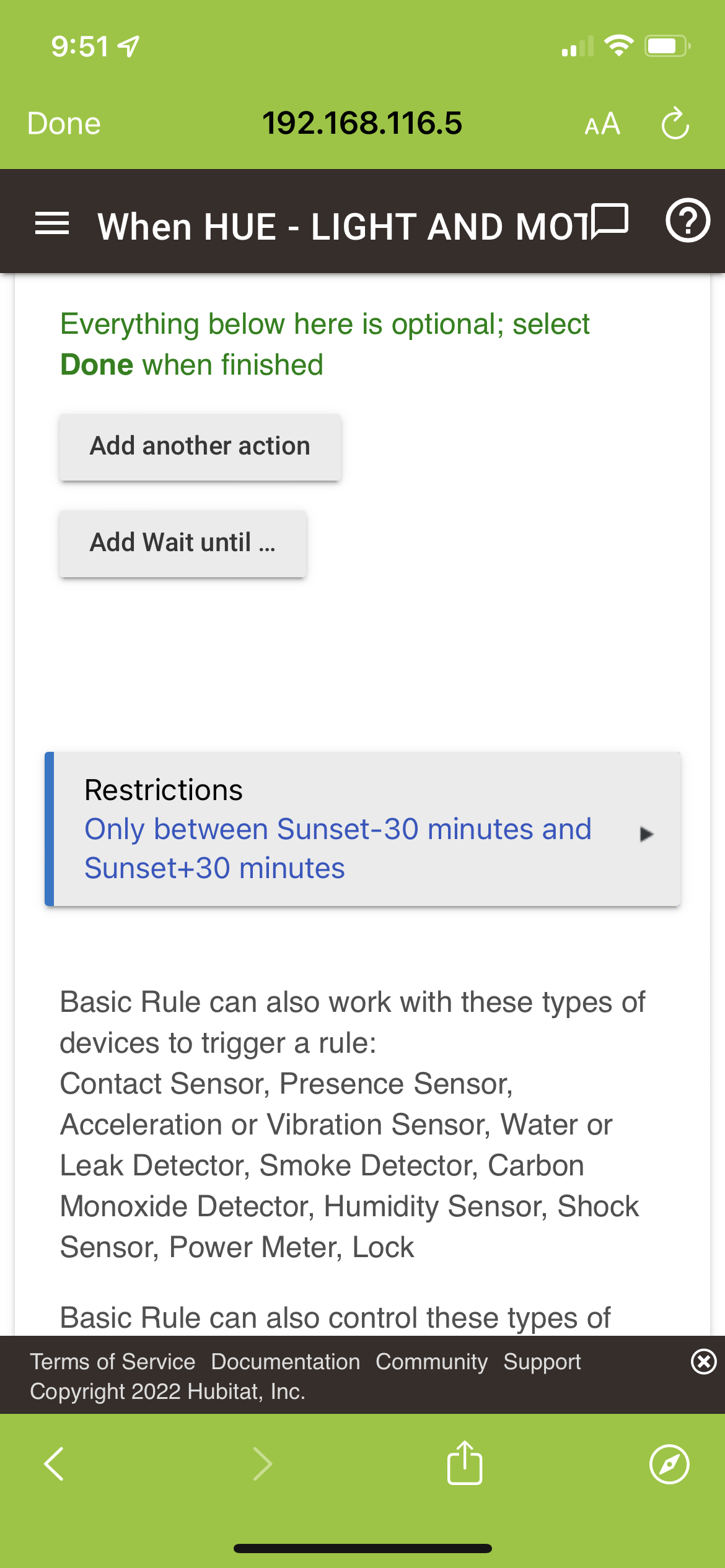

Always says restricted. Deleted and recreated. Same issue. Yes the time is correct. Yes location is correct. It just started doing this after weeks and now I can’t fix it.

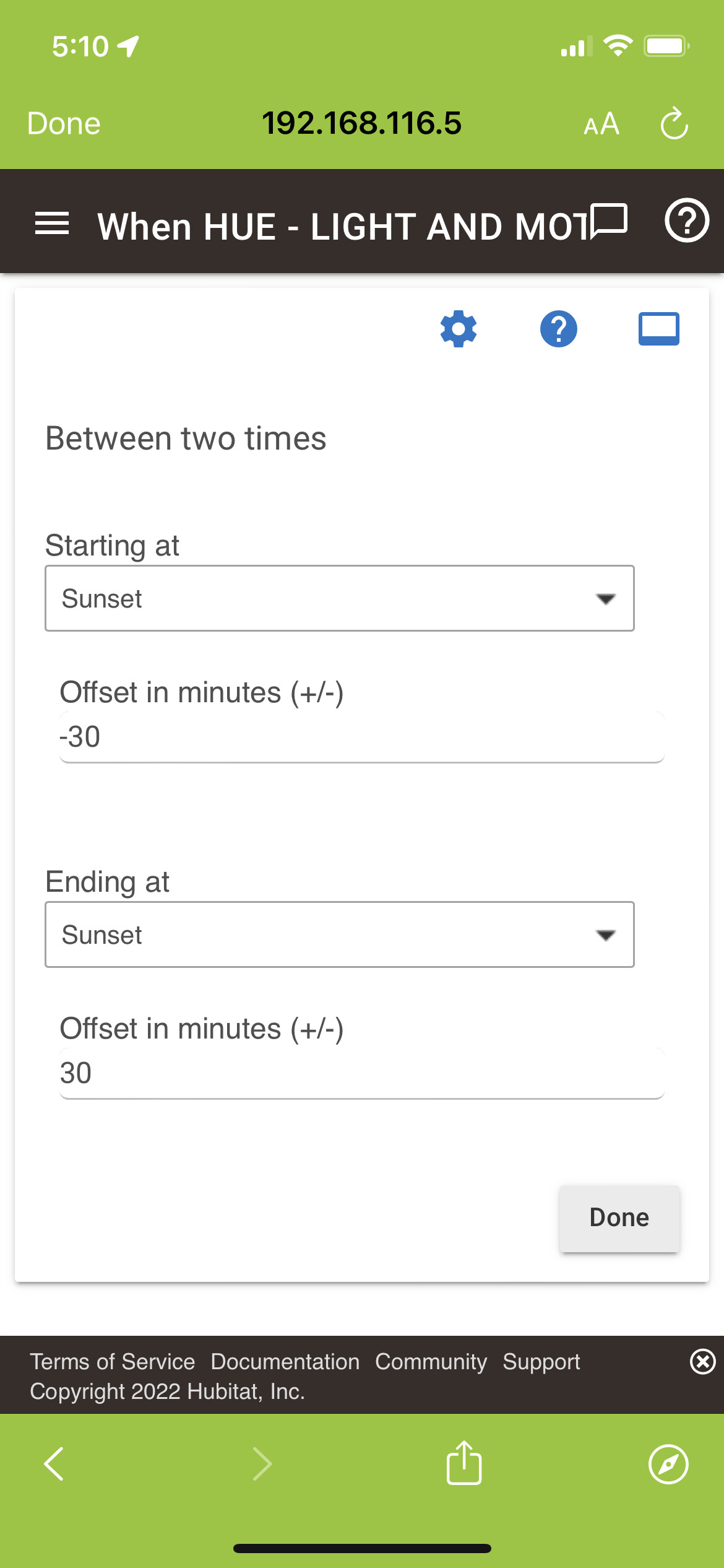

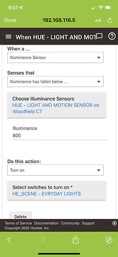

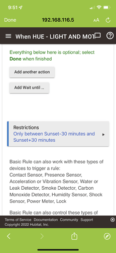

It’s a very large picture. Is your phone small? It’s just a simple rule. Luminance goes below 800 and the lights go on. Works great. As soon as I add the restriction of -30 and +30 from sunset it immediately and always says restricted. Time is correct. Localization is correct.
I can't see any part of a rule. All I see is the picture of sunrise/sunset, and the one with Restricted.
I see nothing about illuminance, or the rules themselves.
That’s the entire rule. These is an issue with it calculation subset and I cannot fix it. Now it’s not reporting restricted.

Perhaps the problem is that the rule is working as configured but it isn't configured as intended?
The issue isn’t the rule. It works. The issue is as soon as I add the sunset plus and minus 30 mins it always thinks it’s restricted until way later. The issue is the restriction not being accurate.
It will be Restricted for all times except for the one hour that begins 30 minutes before sunset. Is that what you intended?

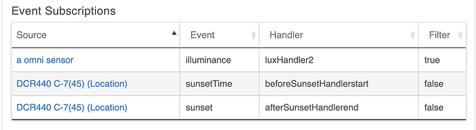

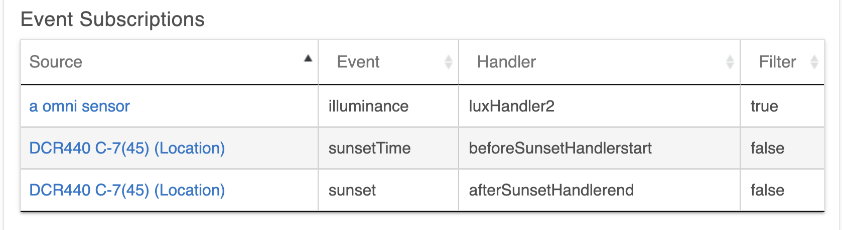

If you look at the App Status page (gear icon), in the section called Event Subscriptions, you should see information like this, only with your sensor and hub name (Location):
Then, nearer the bottom of that page will be a Scheduled Job for tomorrow at 30 minutes before sunset:
Please confirm whether you have similar settings or not.
The answer is - if you edit the rule it breaks and goes restricted until tomorrow. Even a reboot does not fix it. I was trying to guesstimate the lux level and I was changing that value. It’s been fine for days and today I moved it from 800 to 1000 and it’s right back to restricted but I bet it’s ok tomorrow.
Are you past Sunset-30 and before Sunset+30 where you are?
Screen Shot 2022-03-05 at 3.20.32 PM
The rule should show Restricted except for that one hour.
I was right in the time it should work. Tomorrow it will work.

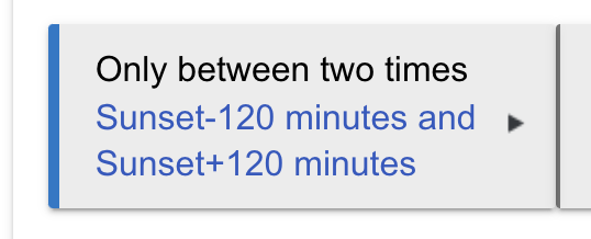

Hmmm, I just set up this restriction below, and it's not saying Restricted:
Screen Shot 2022-03-05 at 4.18.51 PM
But if I change it to this, it does:
Screen Shot 2022-03-05 at 4.20.03 PM
Both of which make sense given the sunset time and current time here.
I'm running on the new beta for 2.3.1, so it's possible that something got fixed here, but I'm not aware of any of this changing since 2.3.0. Hopefully, when you update once 2.3.1 is released it will work right for you.
BTW, it doesn't change whether it says Restricted or not until after Done is hit in the rule.
