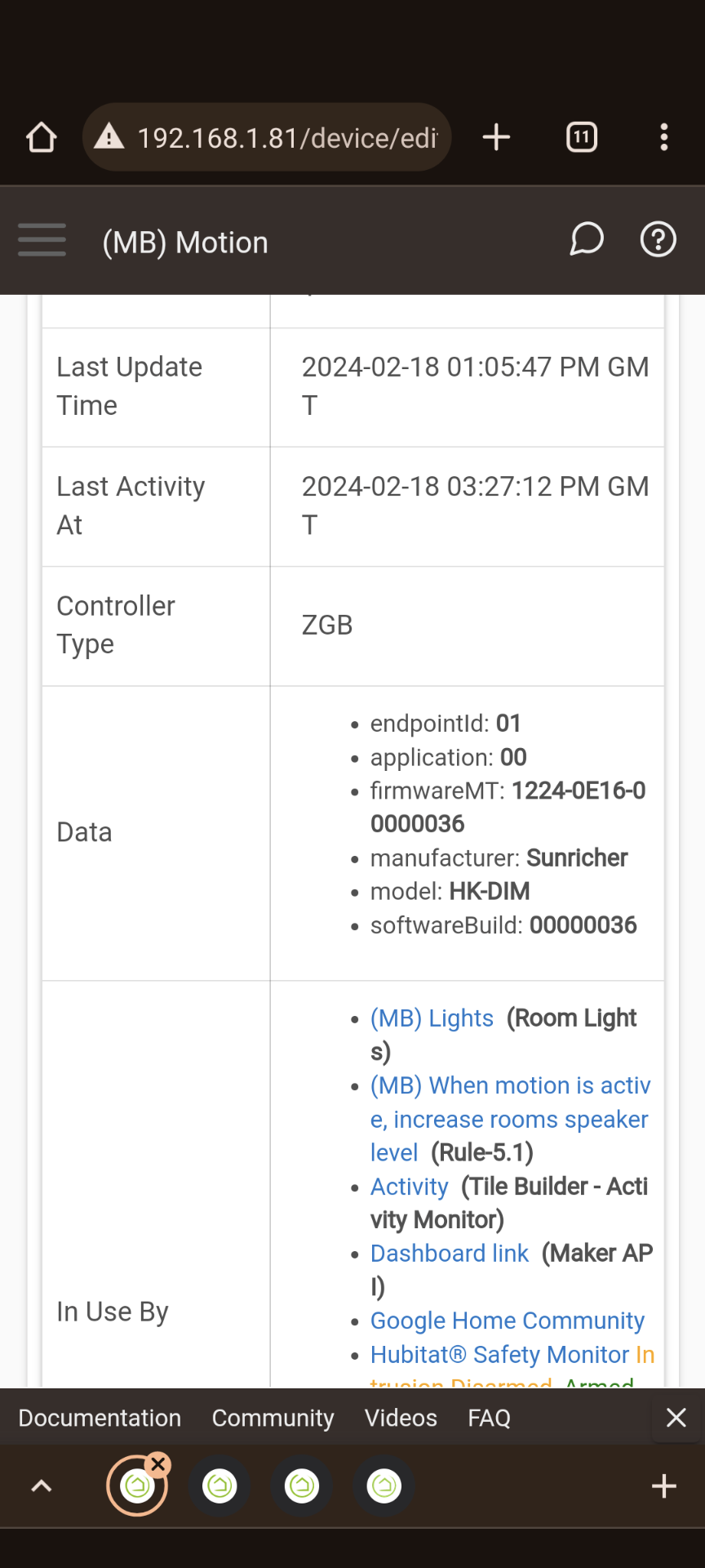

@mike.maxwell got some of these to test they joined find but looks like the configuration done by the driver seems odd?
Looks like things are turned off that don't make sense to, can't be sure.
How did you find them did yours work etc.
Just seemed that they were slow but just shined a light in it and it updated quickly.
Then now it did go active correctly as well.

Also for giggles what is your firmware version?
I’m at 35 FW, the damn LED can’t be turned off, I asked the factory about this.
