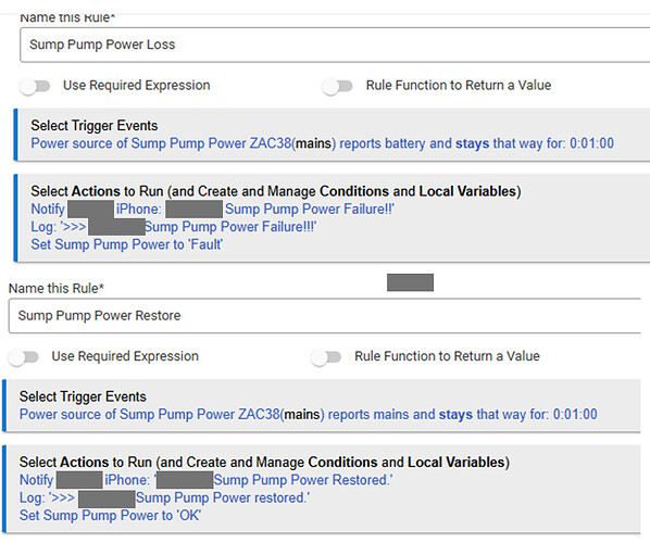

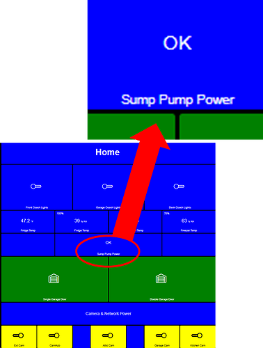

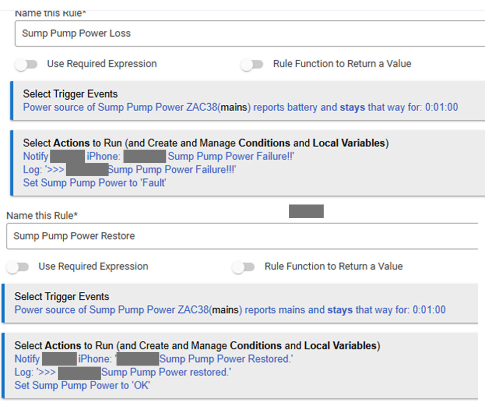

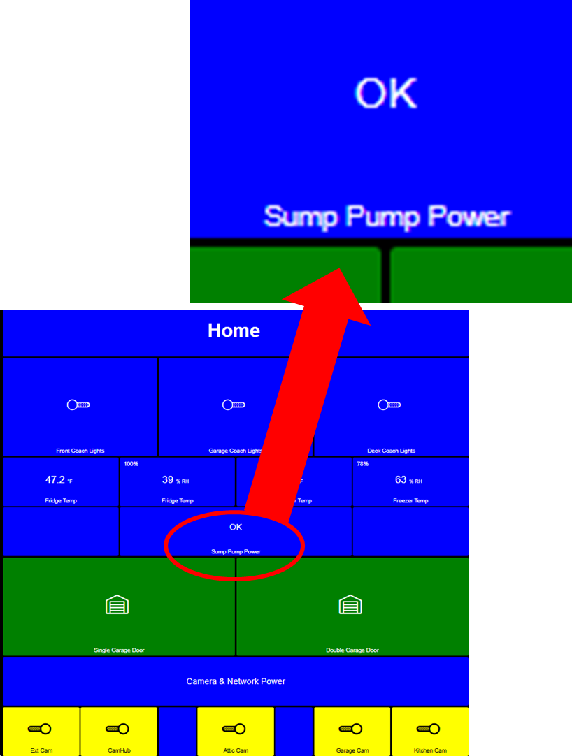

So I put a Zooz ZEN38 into the same outlet as the sump pump. The ZAC38 has a battery so it will report its status even if power to it is lost.
I wrote a couple rules and added an alert tile to one of my dashboards. Now I get alerted if this occurs and I can choose to act on it or at the very least watch (I have an IP camera on the sump pit) the backup to ensure it's keeping up.

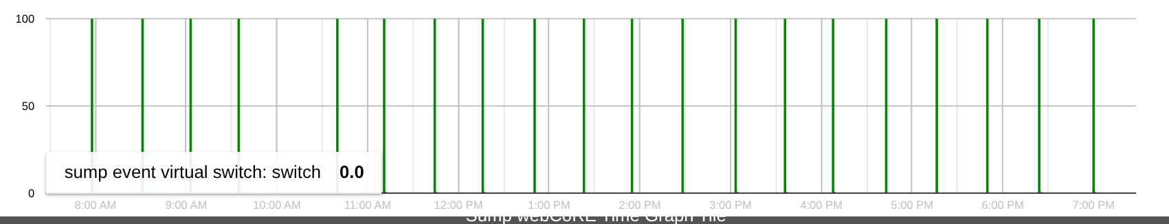

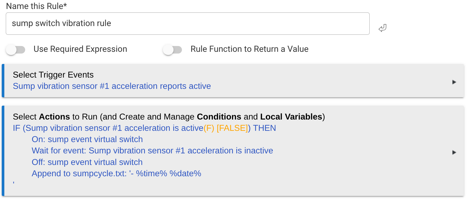

I picked another approach. My sump pump cycles pretty regularly regardless of season. I had been using a Zooz Zen15 to monitor power set to auto-on in the event of power loss. For some reason after several years of perfect performance it failed to come back on. Fortunately I caught it. I now use a vibration sensor placed on the sump discharge pipe. Always works, tracks my pump and can not interrupt power. There are notifications if it doesn't cycle as expected as well as a battery powered back-up.
What sensor do you use?
The Aeotec Multipurpose sensor. Previously a SmarThings device. Amazon link
I use it to trigger a virtual switch which informs a webCoRE graph.
