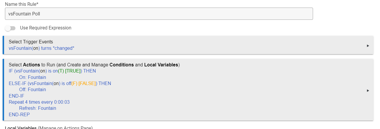

Create a virtual switch of the device.
Add this rule;
For your dashboard, point tile to the virtual switch to control it.

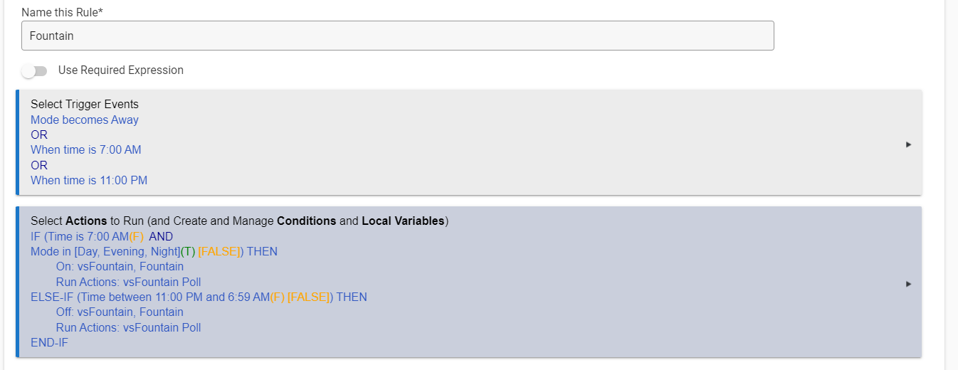

Here is an example rule I now use with this device;
This works, and now it is the fastest tile on my dashboard in terms of status feedback. Watch your logs and see it working for yourself.
