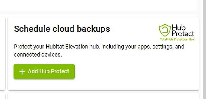

This is what I get rather than the option to create a cloud backup
Milt
Looks like you had 2 Hub Protect subscriptions for the same hub ("Lighting"). One that started on July 2024 and one that started on April 2025. When the older one was cancelled, it disabled the Hub Protect on your hub, even though you still have active service from the new subscription. If you didn't do so already, please go to your hub, then navigate to Backup and Restore and select "Reload entitlements" to reactivate the service locally. Let us know if that doesn't solve your issue.
Running the "Reload entitlements" solved the problem,
Many thanks,
Milt
