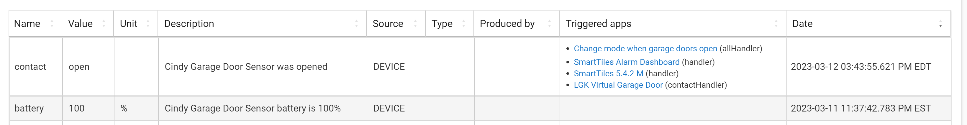

I have one zwave device an ecowitt tilt sensor that is working showing open and close but no messages are appearing in the zwave logs.. I was testing the zen16 which is now directly connected to the c8 vs haveing 2-3 hops in the c7 to see how its routes changed during actual usage when i noticed this anomaly..
same thing happened on closing. the sensor shows close.. no zwave event came accross in the zwave logs.

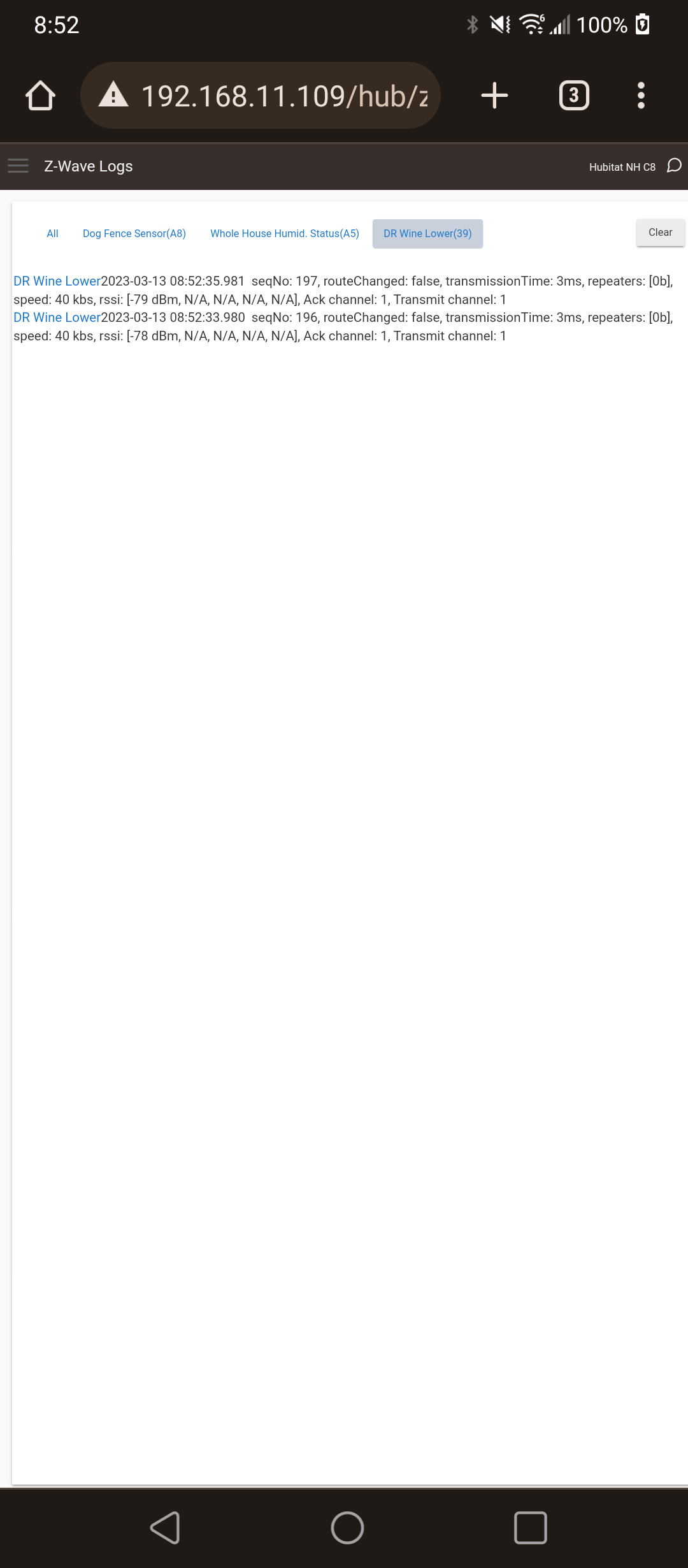

Here are two..
It appears thar you that for some reason only certain sensors types but not all do, as you say, not have incoming messages shown so maybe its some obscure driver option?
Heres another incoming one.
