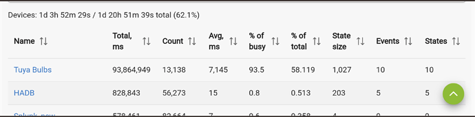

It may help to check the apps and device stats page to see if anything stands out as eating up resources.

I think I need someone to log into my device and look to see what may be a problem device. Everything seems to be working but something is going on and I don't know what to look for as far as when viewing the logs. Example: how many ms is excessive use for some of the apps or devices?

It's less about the ms and more about how much active time a device/app is eating up. For example, the Tuya devices had a bad time yesterday so it's showing a high percentage of busy and total.
I did have an issue with Sengled bulbs (which may actually be Tuya) and switch them to INNR bulbs and all my problems went away. I did find putting a plug socket close to the bulbs helped as it was a repeater. Also when I added a couple of INNR bulbs they also acted as repeaters. The Tuya bulbs are probably not repeaters like the Sengled bulbs are not repeaters.
