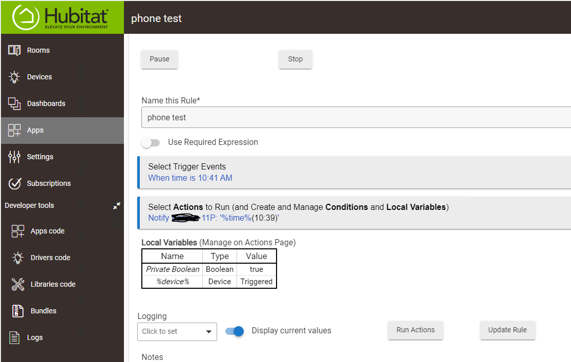

    5 I set up a basic rule. When time is X send an IOS notification. Nothing fancy and it shows under app TOOLS-> NOTIFICATIONS but not in IOS notifications. The things is that this has worked for a year with no changes made to setup.
    6 Enabled only single IOS notification to test any possibility of conflict between rules and no change in status either.
