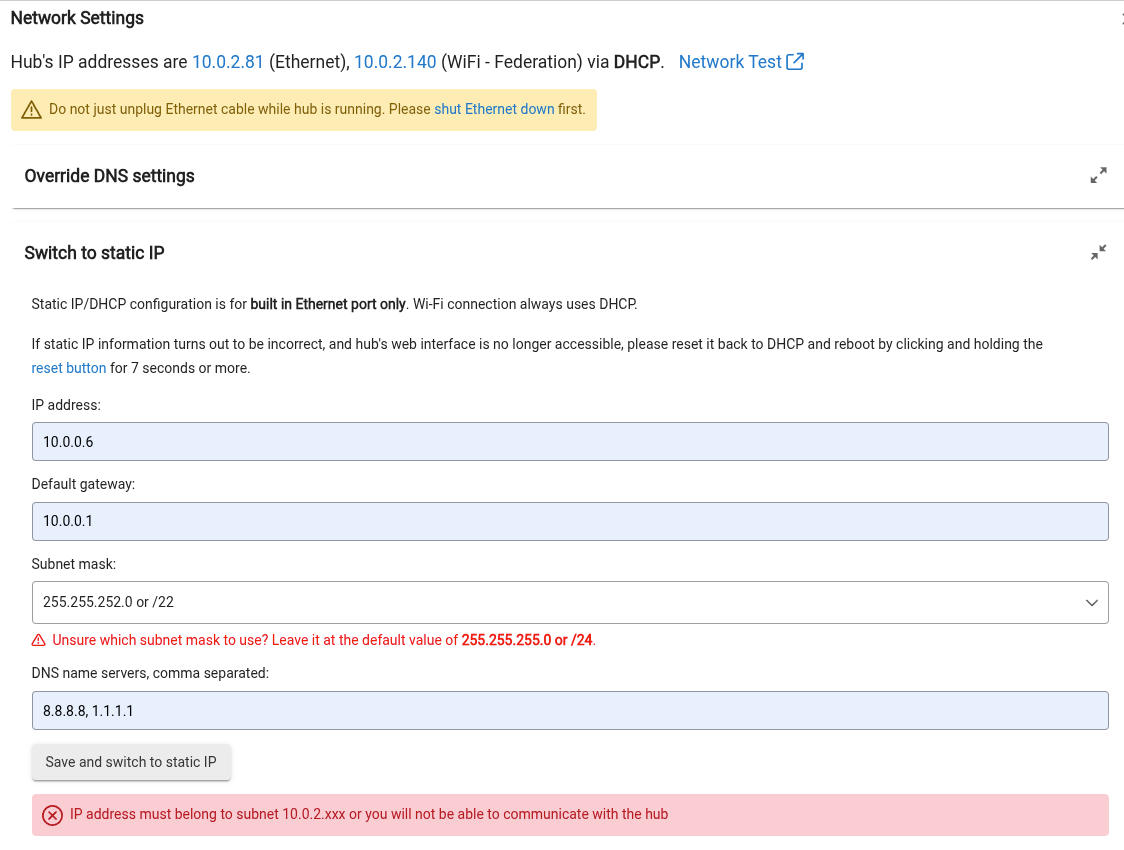

Trying to Switch to static IP of 10.0.0.6 using a /22 subnet, gateway of 10.0.0.1. A valid configuration.
Hubitat refuses, "IP address must belong to subnet 10.0.2.xxx..." which it does under a /22 subnet (10.0.0.1 - 10.0.0.3.255).

Yes there is a workaround, I could simply hardcode the ip in my router. The point is, this is a bug in the core hubitat system that needs addressed.
Yup, been a known bug for few years now... :person_shrugging:
Will the hub accept larger or smaller masks if they are described from a dhcp server?
Yes DHCP is fine, it is just the logic in the UI of static IP input which has the bugs. You can set anything else with DHCP or the endpoint provided.
