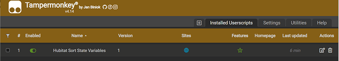

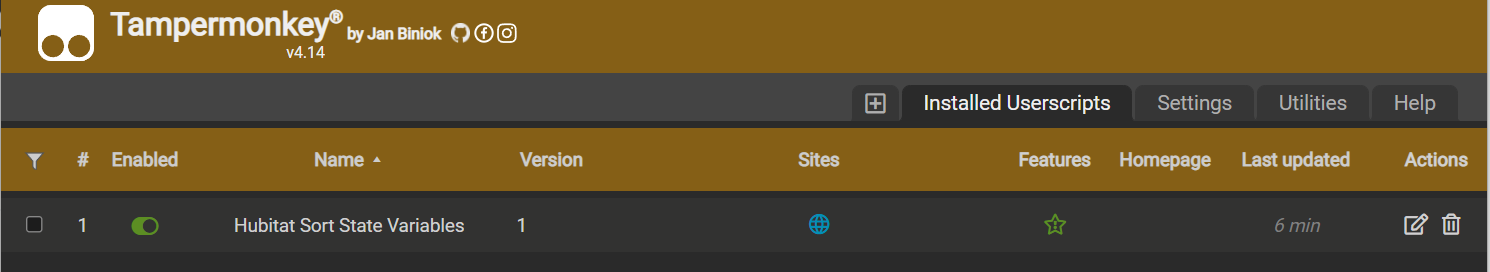

I've loaded this script using TamperMonkey in Chrome. It shows installed and enabled but I'm still not seeing the list sorted. What is the trick to get this to work? I was assuming I just install the script and then refresh/reload the webpage. Is there more that needs to be done?
I just got it to work in TamperMonkey by changing the header part a little, added the description is was complaining about and then also edited the URL to be the exact IP. Something with the wildcard in the middle is not working, I would have to read up on it but this works for me:

Ya know, I kinda wondered about that wildcard. :thinking: Sure enough, I changed it to the exact IP of my hub and its working like a charm. Thanks for the tip! :+1:
I guess the two monkeys have some differences :speak_no_evil:
Greasemonkey handles that inline wildcard, which is handy in case the hub ip changes, but good to know that TamperMonkey doesn't handle it.
Glad you got it working :+1:

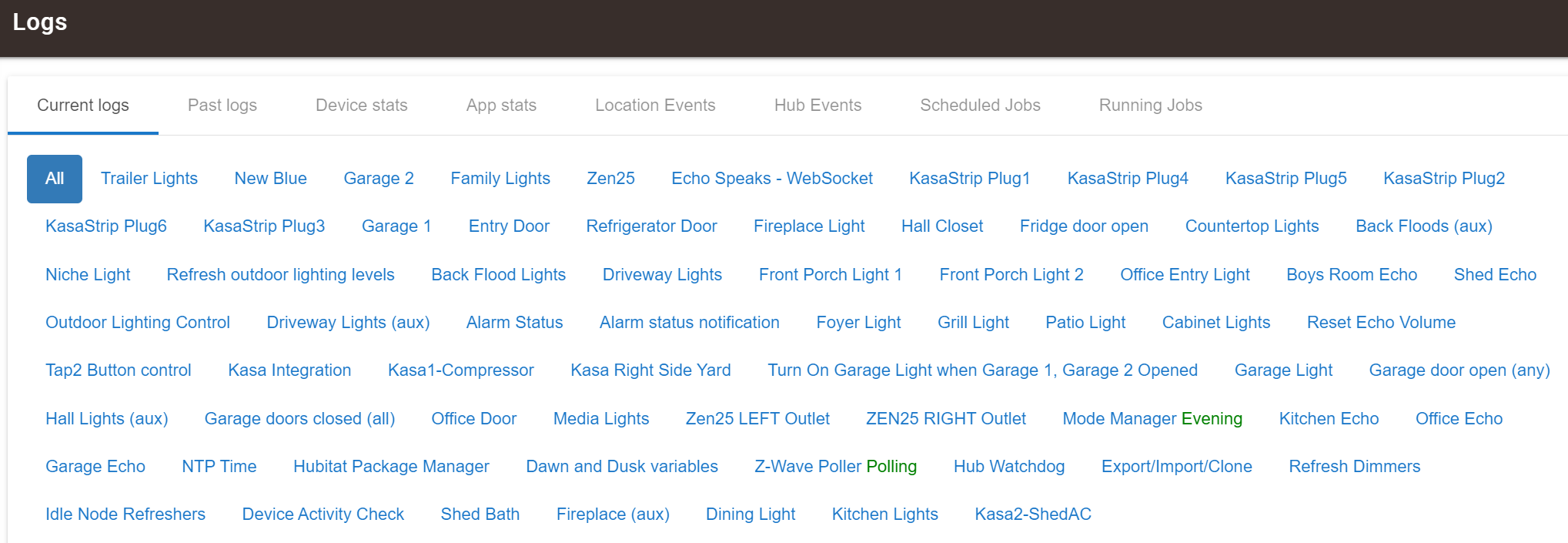

@Darrren its working Great! I had no idea these kind of scripts were possible. Would something like this be able to sort the device list at the top of the Logs page? Thats another area of the HUbitat WebUI that's always bugged me (not sorted)
How true! Funny, I hadn't thought to sort that, but I do spend too much time hunting for devices in that list. It should be possible to sort that, though it will need some extra code since the list is dynamic, with new devices being added as they report in. Sorting that would be really useful, I'll take a look at it...
Here's a Greasemonkey script to sort the device list at the top of the Hubitat logs page. You might need to update the ip address to match your network, and TamperMonkey needs the exact ip address without that middle wildcard.

DUDE! You're awesome! :metal:
It works like a champ.
Haha thanks! I'm liking the script too :smile:
Thanks, thats also a great idea. Always has bothered me being in random order. Probably not random but maybe in the order they appear in the logs, not a useful order.
