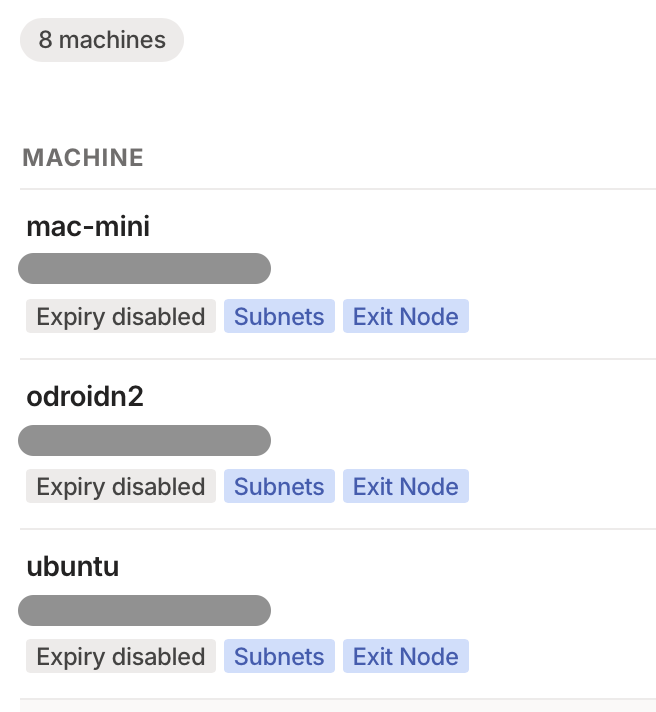

To reiterate what @hubitrep said, you need to mark the RPi as an exit node in the Tailscale admin console. This is in addition to using the flag "--advertise-exit-node" when you start tailscale on the RPi.
I'm running Tailscale exit nodes on three networks. In addition to marking each as an exit node on the admin console, I also disable key expiry, so I'm not caught off guard unable to access a particular network.
Great - thanks @aaiyar @hubitrep for the explanation. I did wonder about that ‘key expiry’ :+1:t2:
