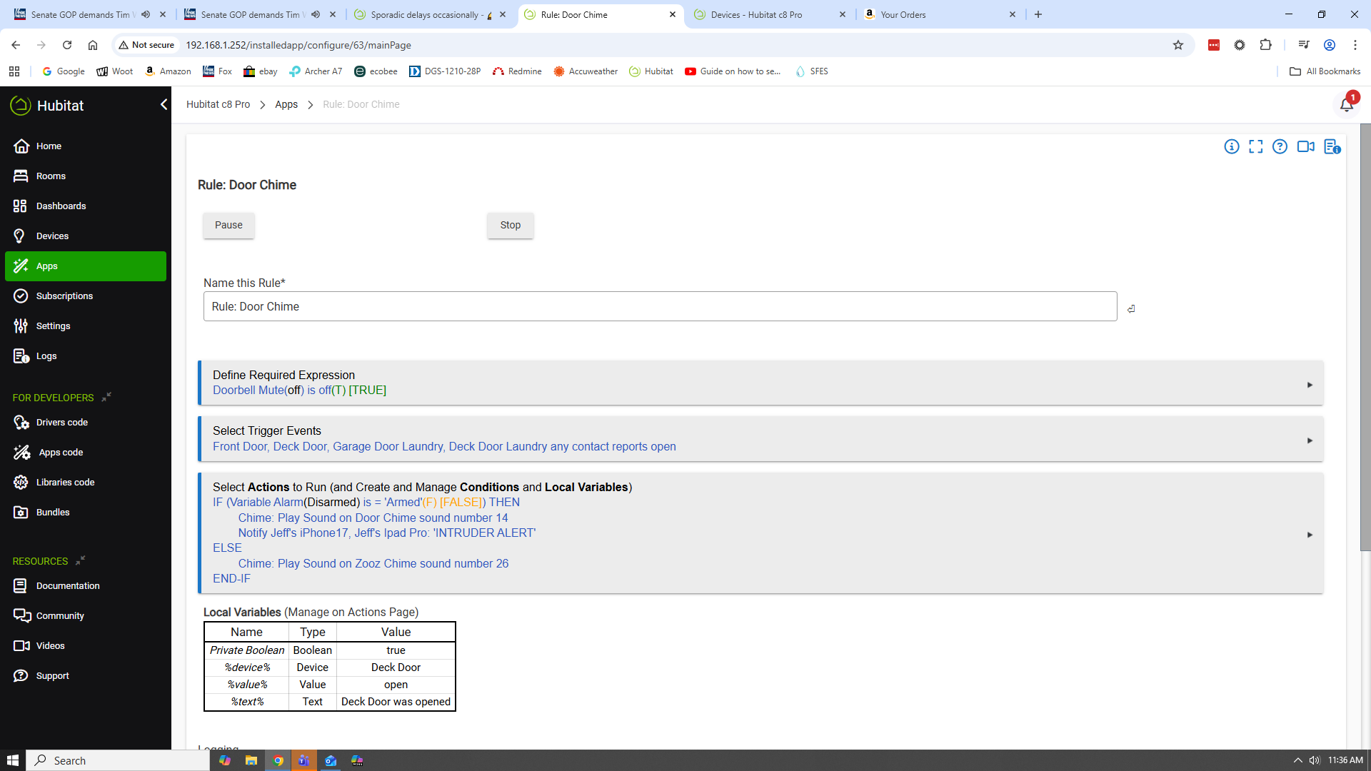

The logs are there, I'm waiting to capture another delay and I will post it then, The devices are an Ecolink zwave door sensor and a ZSE50. They use the following rule...

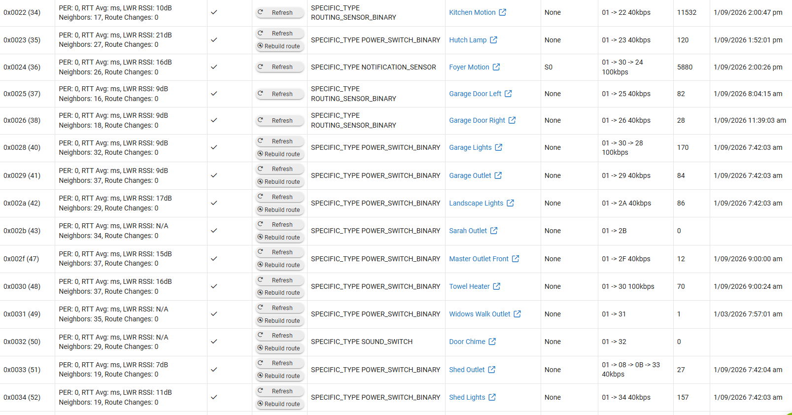

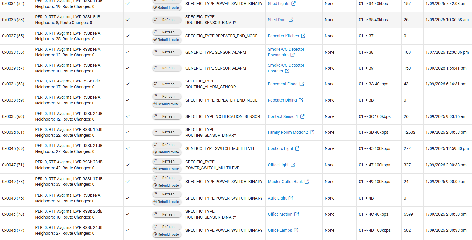

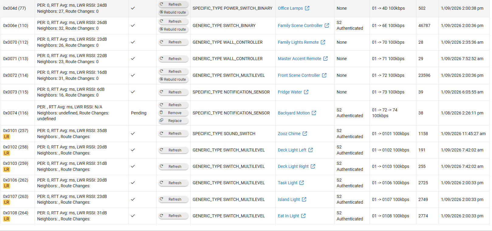

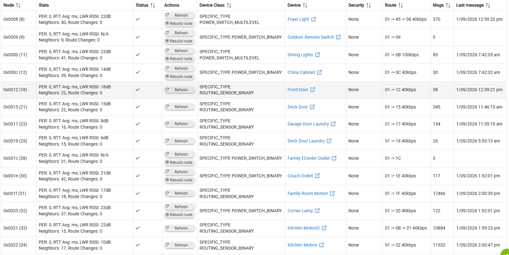

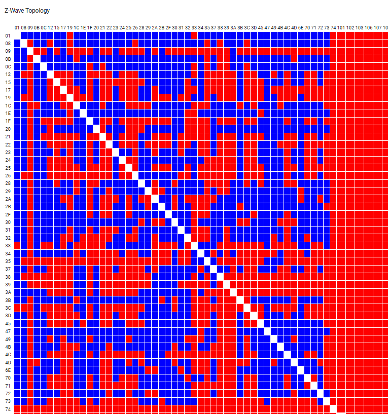

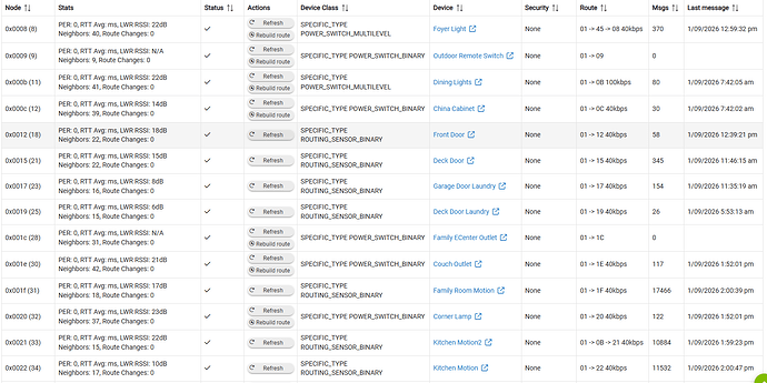

settings>>z-wave details , use windows snip and post your entire z-wave table (there are no personally identifiable things in there)

ID's per the device tab. I assume those are decimal. Not sure how to covert the LR ID (A0) in the chart, but since it's configured as LR, it's direct to the hub which is through two drywall walls and about 8 feet away.
That is the topology map. @rlithgow1 wants to see the table that shows all your devices, status, routes, etc. This is only a snip of mine, but you should include all of your devices. Depending on the amount of devices, you may need to do it in a few clips.
Gotcha.....

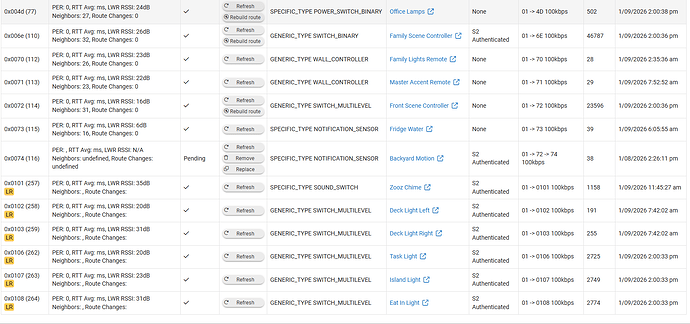

Overall your table looks good. That backyard motion sensor is offline (likely dead battery maybe?)
Just added that two days ago. Brand new so something isn't happy about it.
LOL batteries weren't fully pushed in. A new Zooz ZSE70. Push those batteries in after removing the insulating tabs on them.
The zooz chime is paired in LR mode. How far is it from the hub? Your mesh appears to be pretty good, so I am thinking that the Zooz chime's performance might be better and more consistent if it were paired in mesh mode rather than LR mode.
