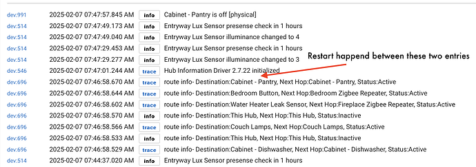

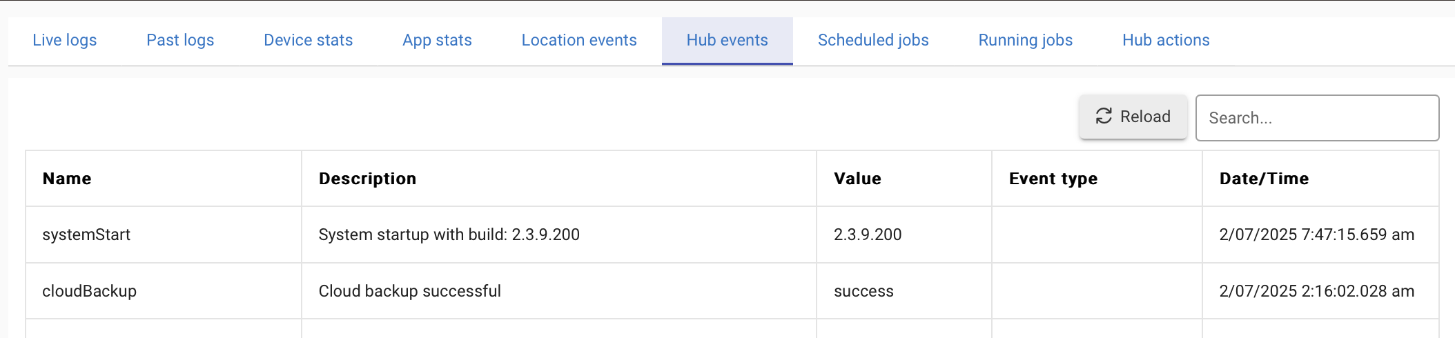

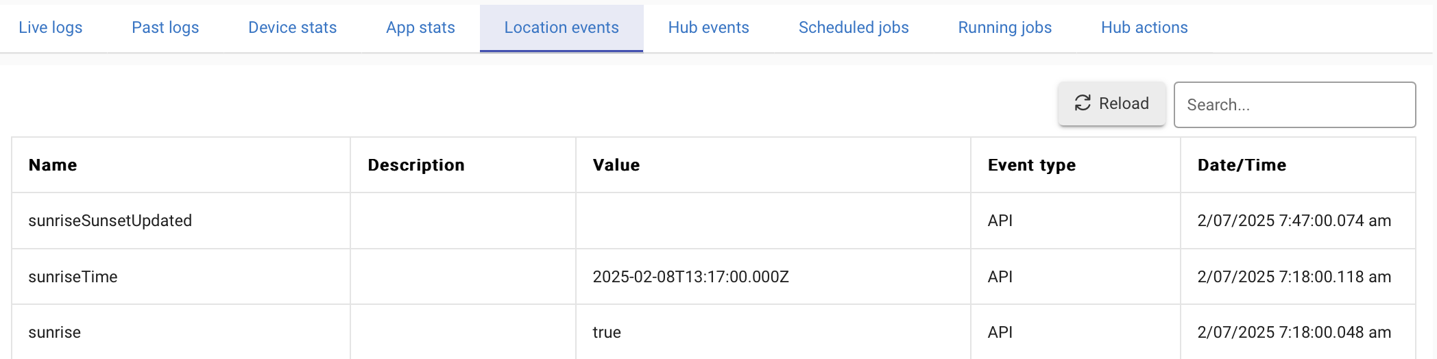

My C-8 has been stable for quite a while and then I just got an unscheduled hub reboot (I have an alert that is sent when the hub restarts). Not sure what caused it - the logs look clean. Though I did see a "elevated load" alert for a brief moment after the reboot but then it disappeared.
No changes to HE (still on platform 2.3.9.200) recently. I have no rules running in HE (all logic is in Node-RED),
Anything that looks strange in the logs?

Momentary power outage?
My first thought as well.
Not that I could see and I was in the same room but with my back to the hub. Also, we have Tesla whole house backup batteries and the hub is attached to a UPS as well. I checked the KASA activity log (the hub is plugged into a Kasa outlet) and there was nothing there either.:man_shrugging:t2:
Are you running this on the OEM power block? If so, and it happens again, you may want to try swapping it out for a new one.
Yes I am. Let me see if this happens again and I will try swapping it out for the one on my spare C-7. I also have a couple of C-5s lying around - do you know if they use the same power brick?
