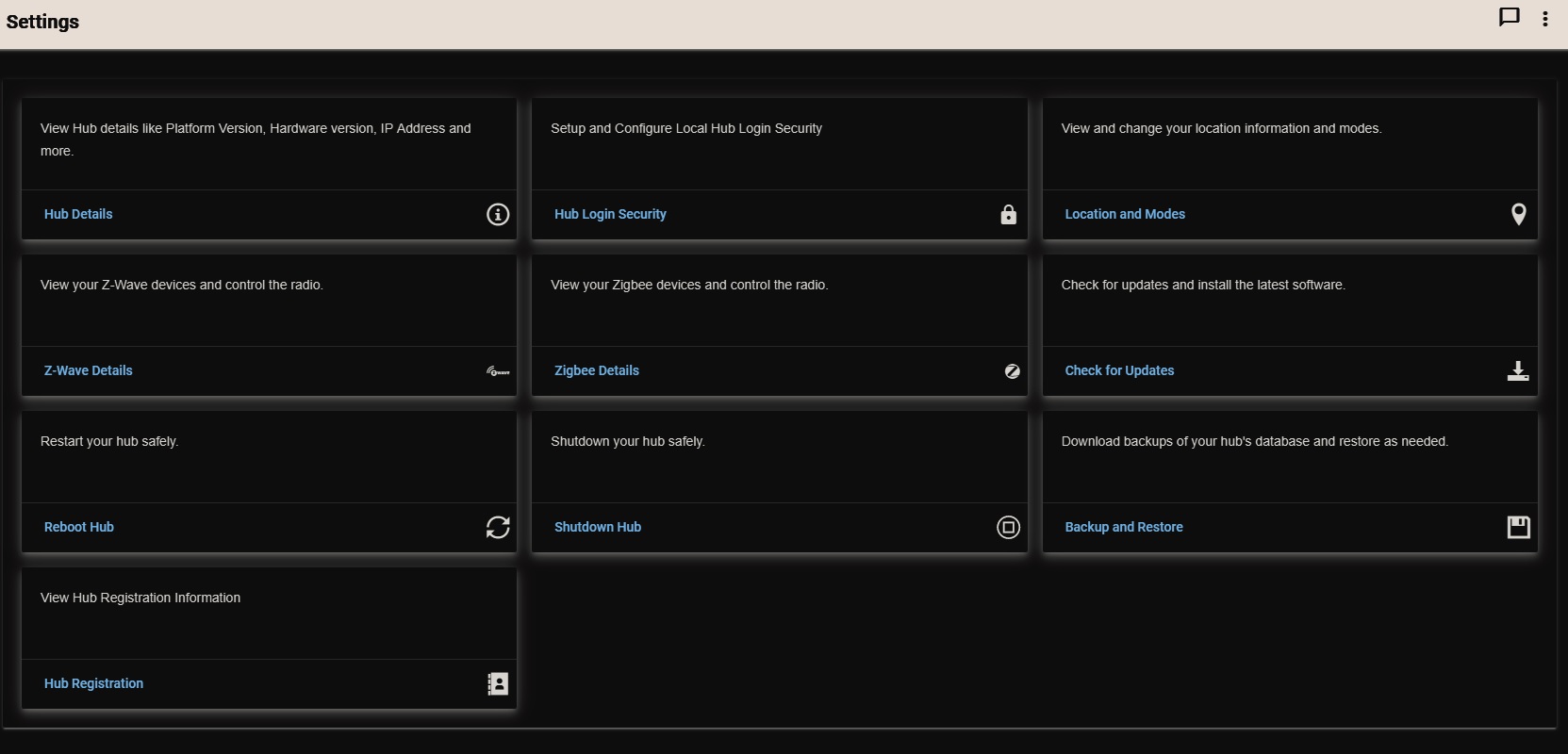

Is there any way to not show the +, check and settings on a dashboard from a local LAN link?
Running 2.3.1.133 on a C-7. Hide 3 dot menu on all tiles, hide tile template names, hide icon helper text, hide text shadow and hide device history are all checked.
