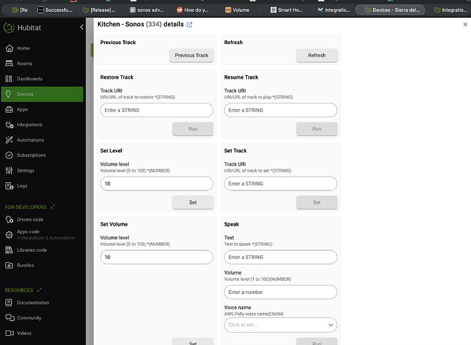

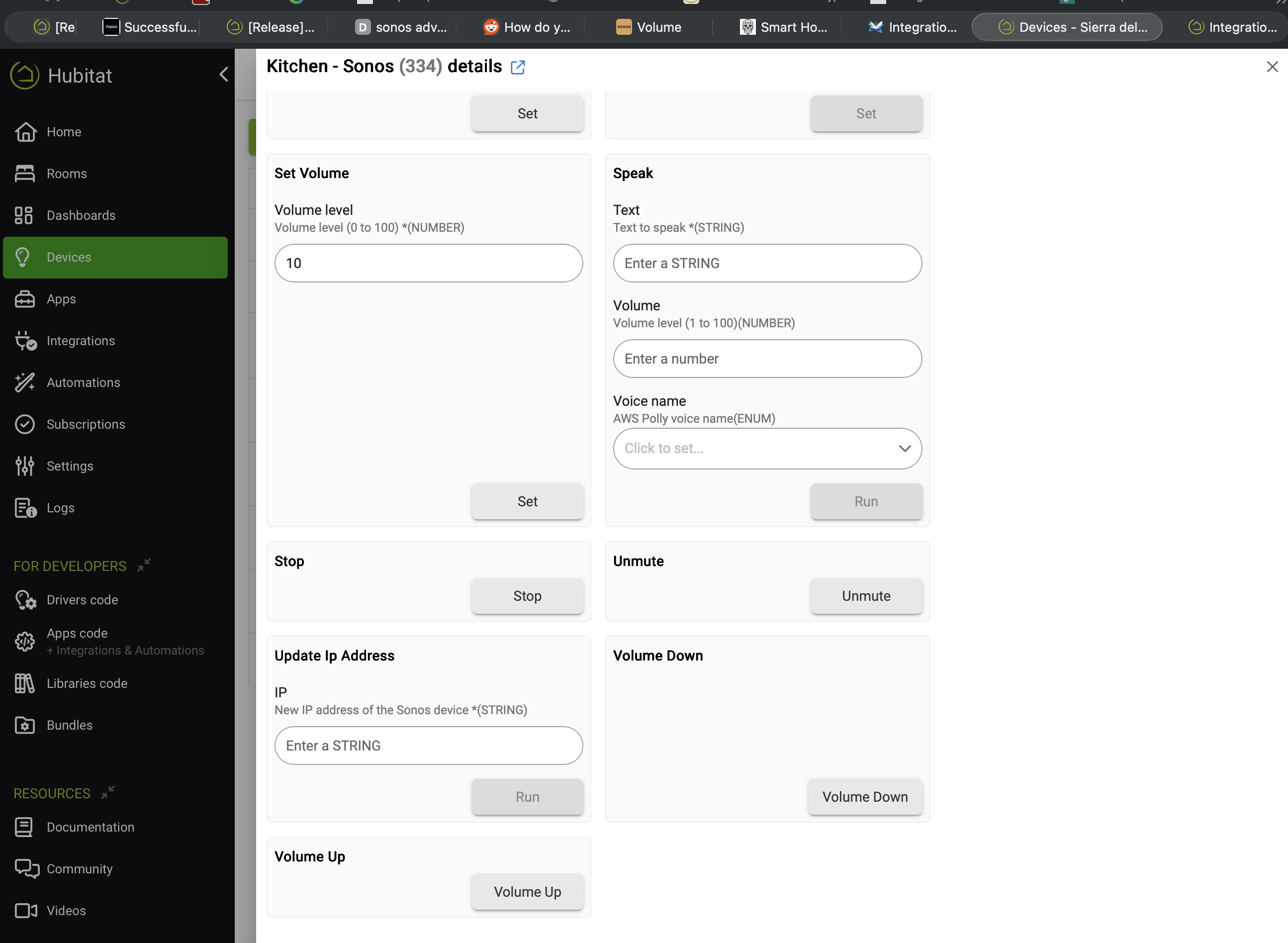

The "Set Level" and "Set Volume" commands have identical behavior in the Sonos Player driver, if that is what you are asking. (Many apps cannot deal with music players directly but can deal with dimmer-type devices, which is where the "Set Level" command can be handy, or at least could when the integration was written early on in the platform's history.)

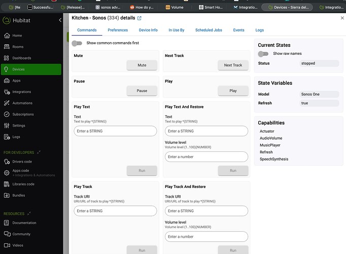

What's missing is info and examples for both the "Commands" and "Preferences" as seen on the created Device pages:
The Sonos Integration is good example in that there are SO many different exposed commands and preferences where it's not exactly clear when, where, and how to use them - especially those that have blank entry fields.

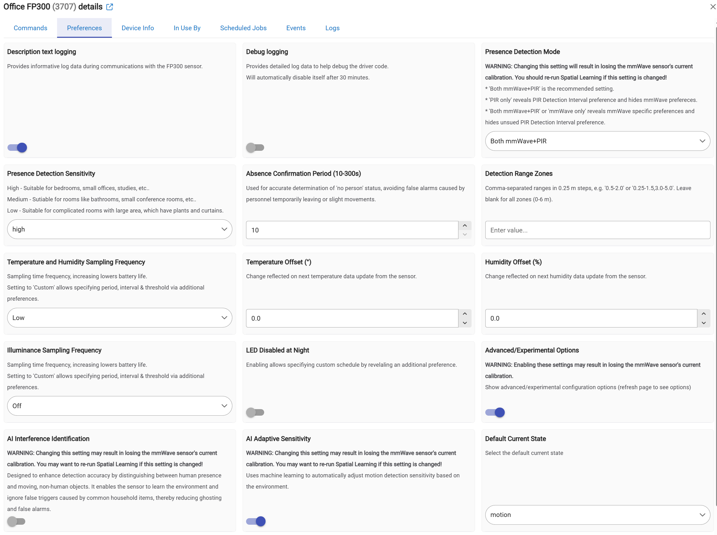

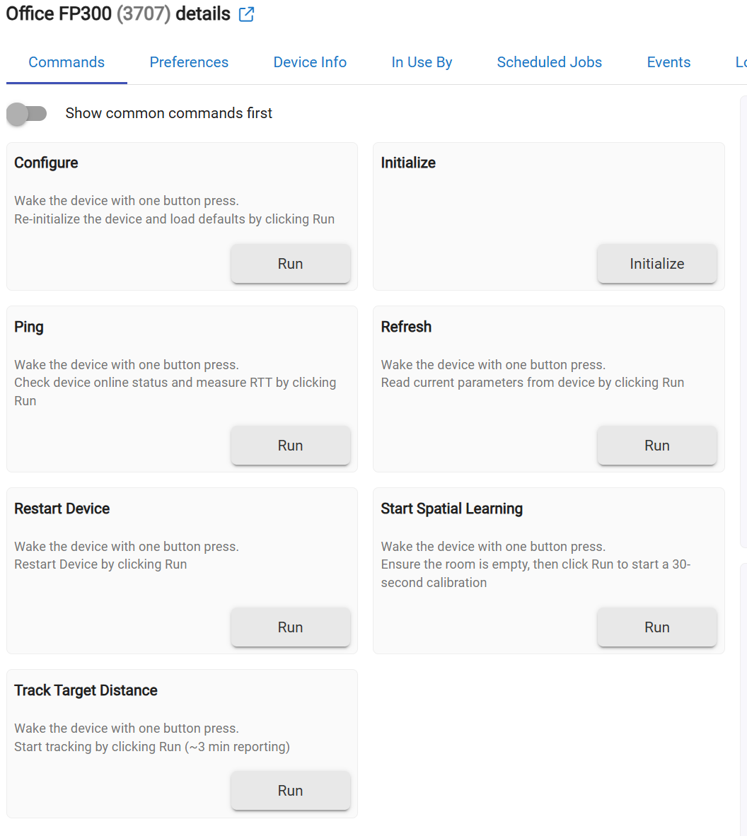

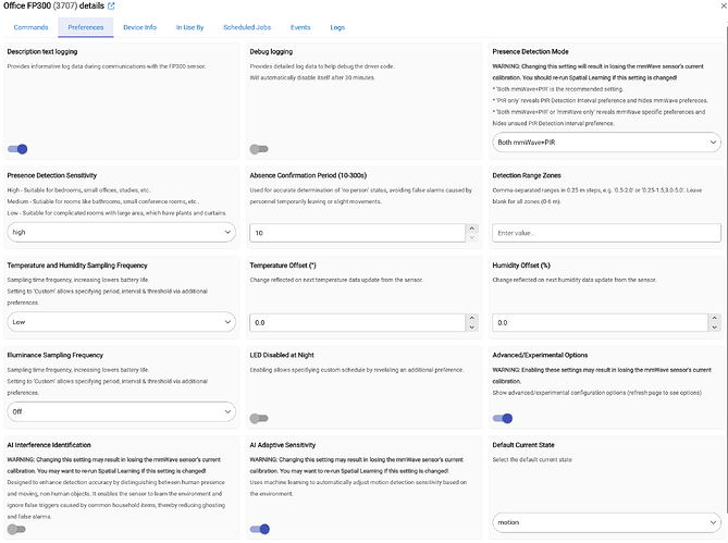

I definitely understand the suggestion and see value in it. However, I wonder if trying to keep separate documentation update for each device is the most effective way of achieving this goal? As a community developer, I do take for granted that the users have a certain baseline of knowledge of the Hubitat platform. Obviously, that is not a fair assumption to make, especially for new users.
Thus, I have been trying to be much more deliberate in documenting commands and user prefefences in the Groovy code, such that the information is available directly from the Hubitat UI for a device.
For example, here is what my Aqara FP300 driver shows the user. I believe documenting these commands and settings in this manner may provide a much better user experience vs expecting users to look up a separate document.
The burden of documenting still relies on the developer. I like to provide this level of information within the device UI as I believe it will result in fewer questions to me via the forum.
Thoughts?
