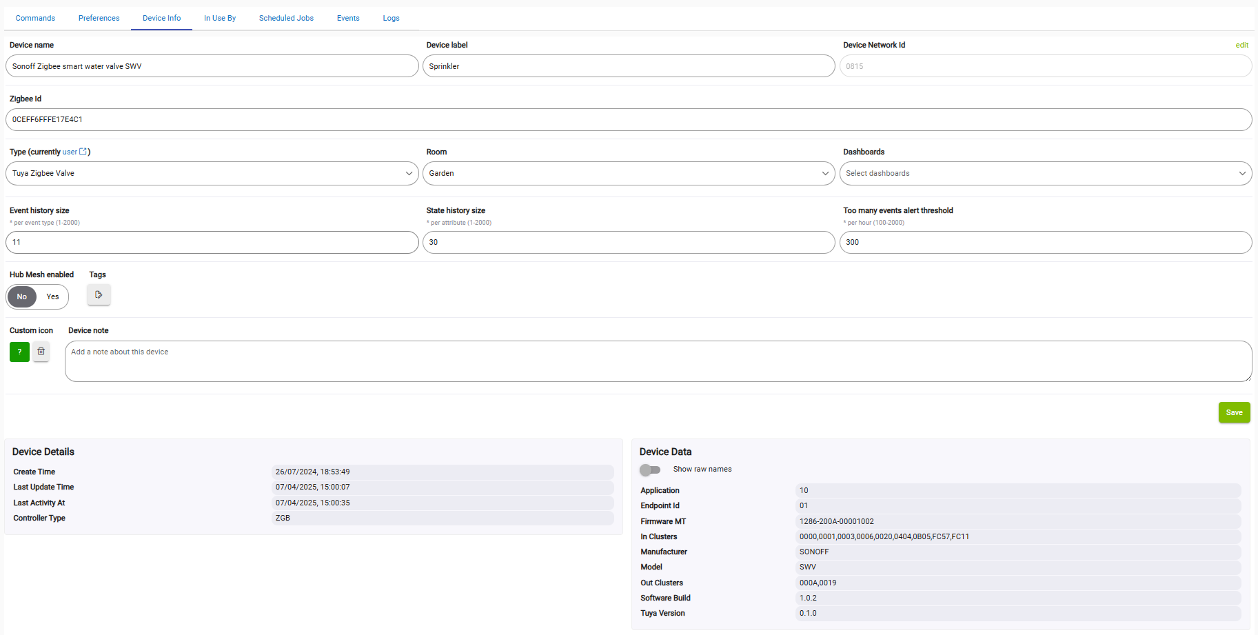

Hi there
I got this valve last summer and had it working great after some tweaks from @kkossev although I dont remember which driver this was with.
I've got the valve out again this year and I can turn the valve on/off but the state always remains as closed
I am running hub version 2.4.1.154 (C9 Pro) and am using version 1.3.3 of the driver
I've re-paired the device a few times, switched to the "Device" driver and back again.....
Not sure if this is your problem but the driver is several versions behind.
Thanks for highlighting, I checked on HPM and it showed no available update.
Have now manually updated and its working fine :slight_smile:
I'm pretty sure that I used HPM. Try a repair in HPM.
