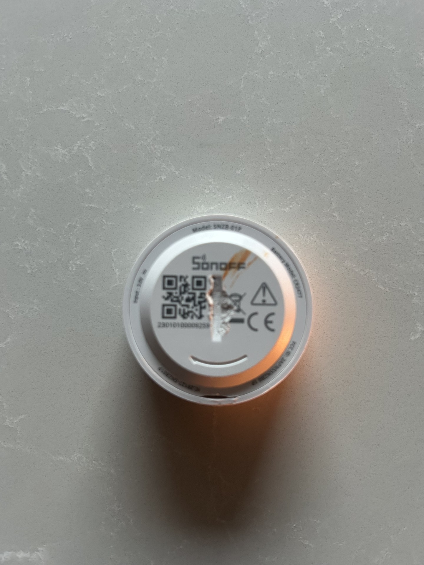

I have a new Sonoff button. As I was playing with it I attempted to remove the back. I have a 1.1 inch diameter disk that fits pretty tight in the slot. I cannot for the life of me rotate the back. I can partially pry up the back but don’t want to snap anything.
Anybody been able to do this?
Something big and flat to turn it…but still….that might even be blood! :face_with_diagonal_mouth:
But as you can see, I have butchered it! It now opens and closes by hand though. :face_with_diagonal_mouth:
Edit: I have also taken the magnet out as it was too strong, pulling the battery out and causing loss of connection on the battery terminals. Other than all this, a good button LOL.

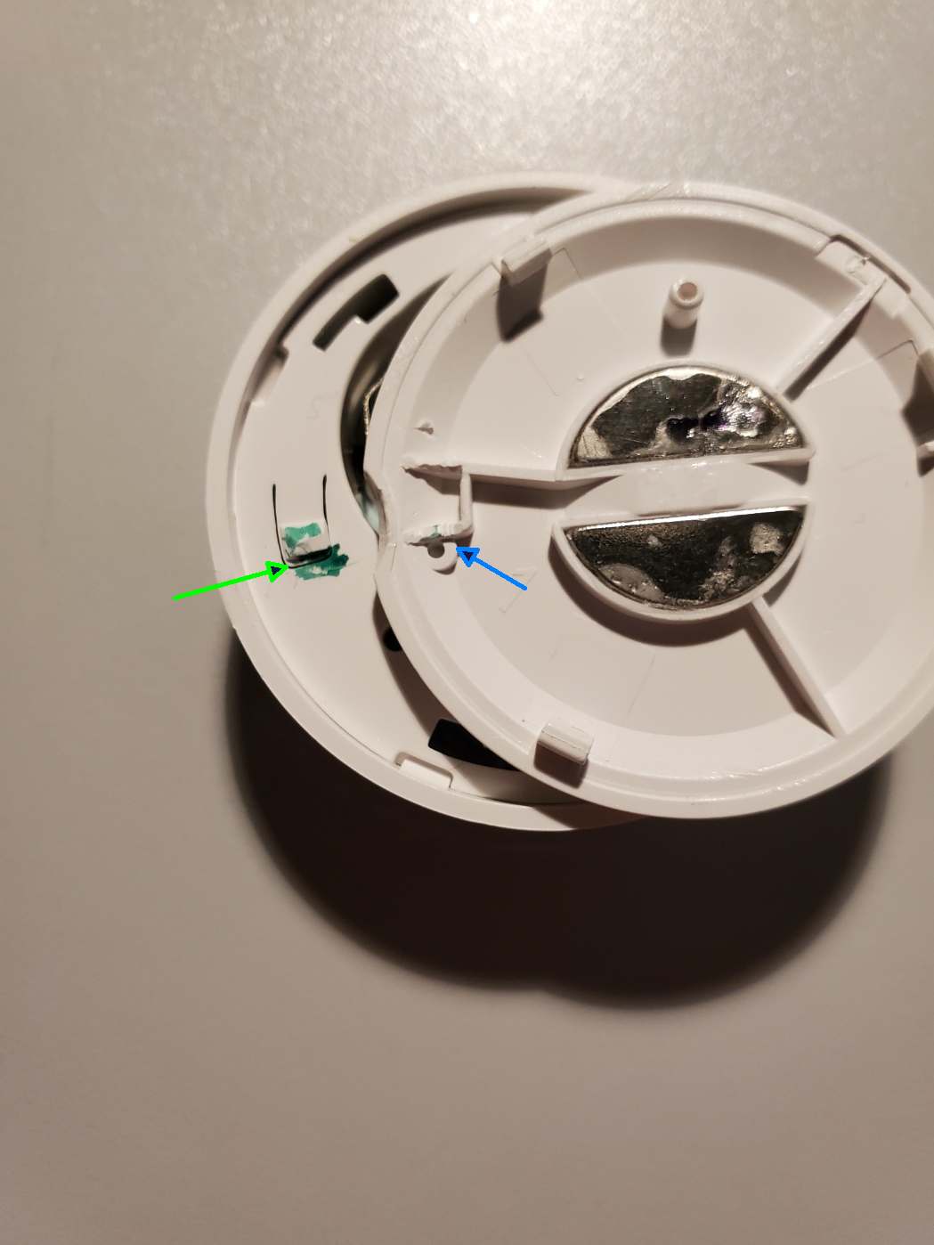

The good news is I found how to make it easier to open and close. Two things:
  1. The pawl (green) that holds the bottom from rotating snaps over the ridge (blue). The pawl has a ramp to click “closed” but the other side of the pawl is a sharp edge. So I cut the blue ridge down and put a slope on the other side of the pawl.
  2. I did not try this but, the small hole on the bottom is right above the pawl. If you put a wire/paper clip in the hole you can depress it and it should open easier. Of course you would need 3 hands.
This is the actual design solution, and yes, you need 3 hands – my wife presses a steel probe through that hole while I hold the case in one hand and use a coin to turn the slotted base. It is infuriating.
I see that now. The graphic could be clearer.
Looks like they’ve tried to improve the design, mine has no hole at the bottom and no brace across the magnet which I’ve had to remove. Not sure which one is the improved design though!
I would guess yours's is the newer design. Simpler magnet shape and no pawl needing the hole in the case and 3 hands to open.
