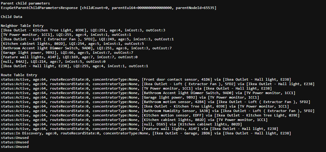

Go to settings/Zigbee Details/Zigbee logging. This will show real time zigbee radio communication and signal strength. Then walk around and trigger things.
You can also go to 192.168.xxx.xxx/hub/zigbee/getChildAndRouteInfo (put your HE address in though)

@Ken_Fraleigh Thanks again, this is what I got (tells me absolutely nothing).
I am assuming that the neighbor table entry indicates devices connected directly to the hub, whilst route table entry are the "piggy backs"? Not sure how to interpret the readings, other than what is connected via what - which seems odd anyway because according to the table, the devices seem to be connected totally randomly with not much consideration to the physical distance between the repeaters etc. ( On paper, there are repeaters much closer than the ones the devices are connected to )

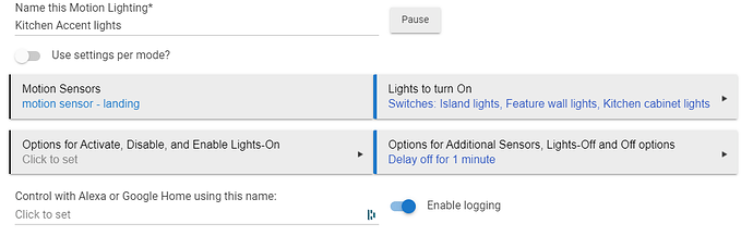

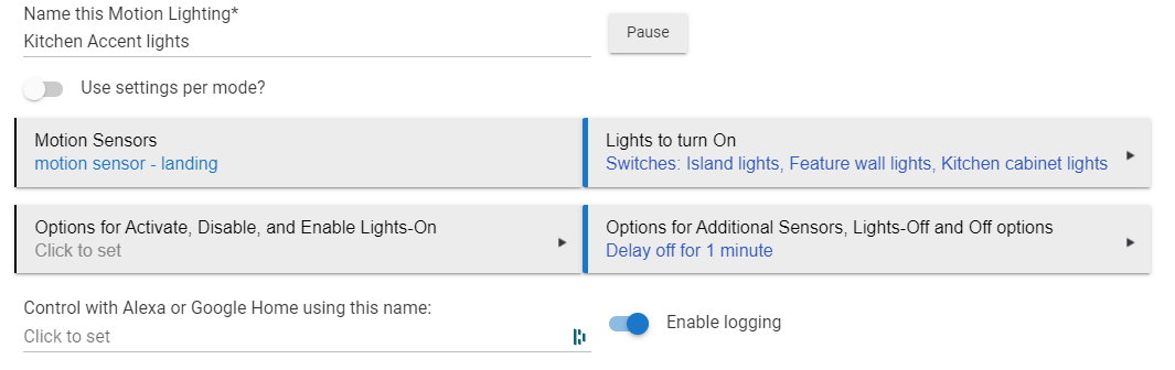

To share some further details, here is what I am running:
Mode and Motion lightning app:
I've enabled the logs, so will see what shows there.
I also don't think it is an issue with the devices I am trying to control ( lights / switches ) as I can operate them via the dashboard and device page - although there could be more to it that I am not considering?

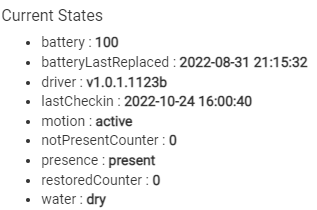

I've changed the driver ( thanks for the tip ) :
Sensor 1:
Sensor 2:
As you can see from the screenshots, sensor 2 seems to think that it also is a water sensor?
I am baffled :sweat_smile:

Me too. :smiley: Did you choose "Motion" or "Moisture" as the driver? They're right next to each other or look similar from what I recall, because I know I've done this before...
