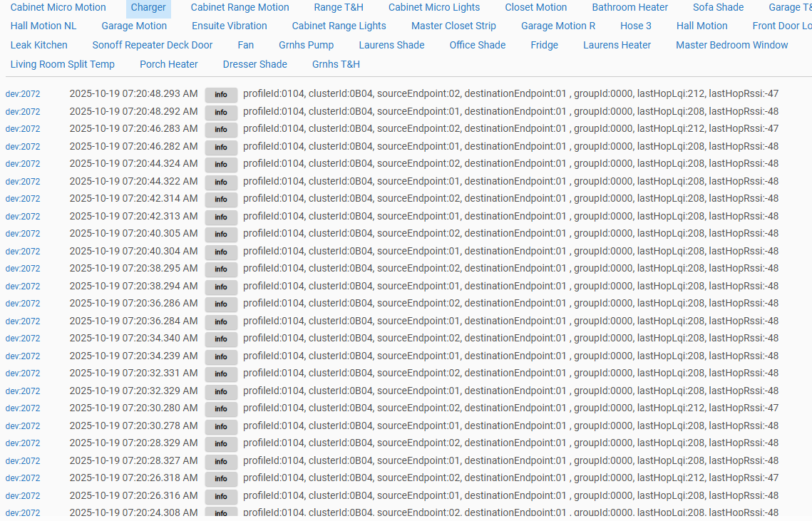

Some smart plugs could be very chatty, even when energy monitoring is not needed and not explicitly configured. See a recent example :
The Tuya plugs from your link should operate quietly, but there is no 100% guarantee. That's why I typically purchase only one unit of a new device for testing.

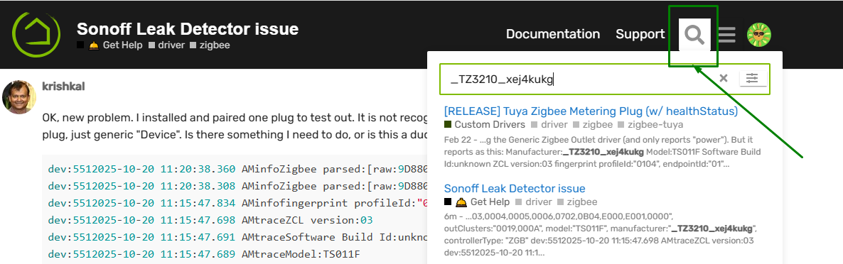

OK, new problem. I installed and paired one plug to test out. It is not recognized as a Zigbee plug, just generic "Device". Is there something I need to do, or is this a dud? Here is the log:
dev:5512025-10-20 11:20:38.360 AMinfoZigbee parsed:[raw:9D88010B041E0505217B0008052100000B05290000, dni:9D88, endpoint:01, cluster:0B04, size:1E, attrId:0505, encoding:21, command:0A, value:007B, clusterInt:2820, attrInt:1285, additionalAttrs:[[value:0000, encoding:21, attrId:0508, consumedBytes:5, attrInt:1288], [value:0000, encoding:29, attrId:050B, consumedBytes:5, attrInt:1291]]]
dev:5512025-10-20 11:20:38.308 AMinfoZigbee parsed:[raw:9D8801070212000025000000000000, dni:9D88, endpoint:01, cluster:0702, size:12, attrId:0000, encoding:25, command:0A, value:000000000000, clusterInt:1794, attrInt:0]
dev:5512025-10-20 11:15:47.834 AMinfofingerprint profileId:"0104", endpointId:"01", inClusters:"0003,0004,0005,0006,0702,0B04,E000,E001,0000", outClusters:"0019,000A", model:"TS011F", manufacturer:"_TZ3210_xej4kukg", controllerType: "ZGB"
dev:5512025-10-20 11:15:47.698 AMtraceZCL version:03
dev:5512025-10-20 11:15:47.691 AMtraceSoftware Build Id:unknown
dev:5512025-10-20 11:15:47.689 AMtraceModel:TS011F
dev:5512025-10-20 11:15:47.686 AMtraceManufacturer:_TZ3210_xej4kukg
dev:5512025-10-20 11:15:47.571 AMdebuggetting info for unknown Zigbee device...
dev:5512025-10-20 11:15:45.071 AMinfoZigbee parsed:[raw:9D8801E0000C01D048020006, dni:9D88, endpoint:01, cluster:E000, size:0C, attrId:D001, encoding:48, command:0A, value:020006, clusterInt:57344, attrInt:53249]
dev:5512025-10-20 11:15:45.014 AMinfoZigbee parsed:[raw:9D8801E0000C02D04802000A, dni:9D88, endpoint:01, cluster:E000, size:0C, attrId:D002, encoding:48, command:0A, value:02000A, clusterInt:57344, attrInt:53250]
dev:5512025-10-20 11:15:42.437 AMinfoZigbee parsed:[raw:9D8801E0015E10D0300230D0300000D0200101D01B0000000002D0234D24290003D0238200000004D023D42A000005D02337050000, dni:9D88, endpoint:01, cluster:E001, size:5E, attrId:D010, encoding:30, command:0A, value:02, clusterInt:57345, attrInt:53264, additionalAttrs:[[value:00, encoding:30, attrId:D030, consumedBytes:4, attrInt:53296], [value:01, encoding:20, attrId:D000, consumedBytes:4, attrInt:53248], [value:00000000, encoding:1B, attrId:D001, consumedBytes:7, attrInt:53249], [value:0029244D, encoding:23, attrId:D002, consumedBytes:7, attrInt:53250], [value:00000082, encoding:23, attrId:D003, consumedBytes:7, attrInt:53251], [value:00002AD4, encoding:23, attrId:D004, consumedBytes:7, attrInt:53252], [value:00000537, encoding:23, attrId:D005, consumedBytes:7, attrInt:53253]]]
dev:5512025-10-20 11:15:42.327 AMinfoZigbee parsed:[raw:9D880100063C000010000140210000024021000001803001028030020050300100801000, dni:9D88, endpoint:01, cluster:0006, size:3C, attrId:0000, encoding:10, command:0A, value:00, clusterInt:6, attrInt:0, additionalAttrs:[[value:0000, encoding:21, attrId:4001, consumedBytes:5, attrInt:16385], [value:0000, encoding:21, attrId:4002, consumedBytes:5, attrInt:16386], [value:01, encoding:30, attrId:8001, consumedBytes:4, attrInt:32769], [value:02, encoding:30, attrId:8002, consumedBytes:4, attrInt:32770], [value:01, encoding:30, attrId:5000, consumedBytes:4, attrInt:20480], [value:00, encoding:10, attrId:8000, consumedBytes:4, attrInt:32768]]]
dev:5512025-10-20 11:15:42.251 AMinfoZigbee parsed:[raw:9D8801E0000C02D04802000A, dni:9D88, endpoint:01, cluster:E000, size:0C, attrId:D002, encoding:48, command:0A, value:02000A, clusterInt:57344, attrInt:53250]
dev:5512025-10-20 11:15:42.187 AMinfoZigbee parsed:[raw:9D8801E0000C01D048020006, dni:9D88, endpoint:01, cluster:E000, size:0C, attrId:D001, encoding:48, command:0A, value:020006, clusterInt:57344, attrInt:53249]
dev:5512025-10-20 11:15:42.127 AMinfoZigbee parsed:[raw:9D88010B041E0505217B0008052100000B05290000, dni:9D88, endpoint:01, cluster:0B04, size:1E, attrId:0505, encoding:21, command:0A, value:007B, clusterInt:2820, attrInt:1285, additionalAttrs:[[value:0000, encoding:21, attrId:0508, consumedBytes:5, attrInt:1288], [value:0000, encoding:29, attrId:050B, consumedBytes:5, attrInt:1291]]]
dev:5512025-10-20 11:15:42.064 AMinfoZigbee parsed:[raw:9D8801070212000025000000000000, dni:9D88, endpoint:01, cluster:0702, size:12, attrId:0000, encoding:25, command:0A, value:000000000000, clusterInt:1794, attrInt:0]
dev:5512025-10-20 11:15:38.614 AMinfoZigbee parsed:[raw:9D8801070212000025000000000000, dni:9D88, endpoint:01, cluster:0702, size:12, attrId:0000, encoding:25, command:0A, value:000000000000, clusterInt:1794, attrInt:0]
dev:5512025-10-20 11:15:37.539 AMdebuggetting device info in 10 seconds...
For full functionalities of Tuya devices you can search this forum for a community driver :
For a simple on/off function - use the HE inbuilt 'Generic Zigbee Outlet' or 'Generic Zigbee Switch' drivers.
But, to use this device as a repeater only, actually you don't need any driver! It is enough to have the mains-powered Zigbee device paired to your HE hub.
