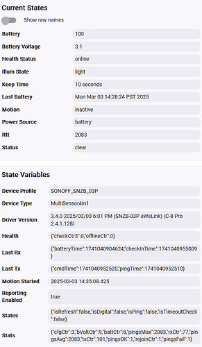

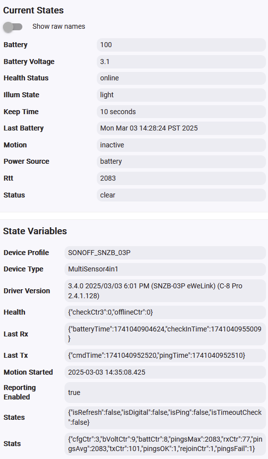

Everything seems to be working fine on my two SNZB-06P sensors; this is State info for one of them:
