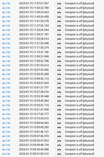

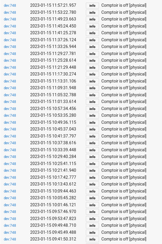

Here is an exemple of one device. I have 34 like that.
It does not bother me. It just fill the log with useless info.

The "physical" between brakets in the log tells you it originate from the device itself. As Mike stated, these seems to ignore the reporting interval set by the driver so they will send their heartbeat at their own rate regardless of any app or driver setting. (In my case every 239 seconds exactly)
