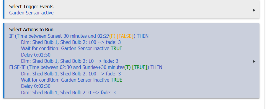

hi guys can i get some help i have all my external light come on 10% at Sunset from a simple rule
then in rule machine
when there is motion i have it capture the go upto 100% then wait for the sensor to be inactive before it restores
but my problem is if i get motion again before it dims back down im sure the capture runs again but now doing so at 100% resulting it runing all but when it comes to doing the restore it then now does so at 100%
i hope this make sense
please ignore the delay time as that should be 2:30
or is there a way to set this up in motion lighting but keeping the defalut 10% dim lights after motion

When motion is active the lights Dim to 100%. What's different is the state the lights go to when motion is inactive. Here's how I'd write your rule:
Tigger:
Garden Sensor active
Action:
Cancel Delayed Actions
Dim: Shed Bulb 1, Shed Bulb 2: 100 --> fade: 3
Wait for condition: Garden Sensor inactive
Delay 0:02:30 (cancelable)
IF (Time between Sunset-30 and 2:30) Dim:Shed Bulb 1, Shed Bulb 2: 10 --> fade: 3
IF (Time between 2:30 and Sunrise+30) Dim:Shed Bulb 1, Shed Bulb 2: 0 --> fade: 3

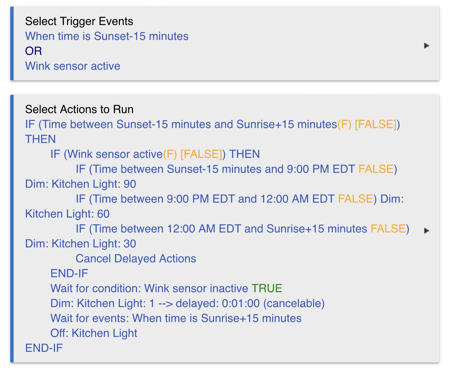

I use this rule for my kitchen lights. I think it’s similar to what you are trying to do. At sunset the lights come on to dim setting 1. When there is motion the dimmer setting changes depending on what time of night it is and then goes back to dim setting 1 once motion has stopped. At sunrise the lights turn off.
