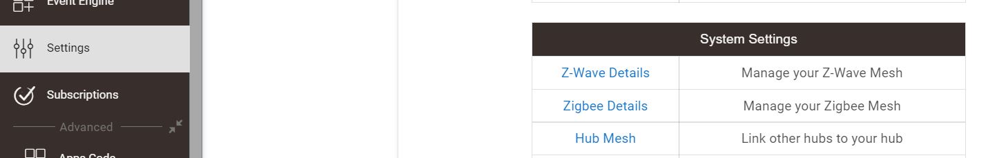

Accessed from Settings...

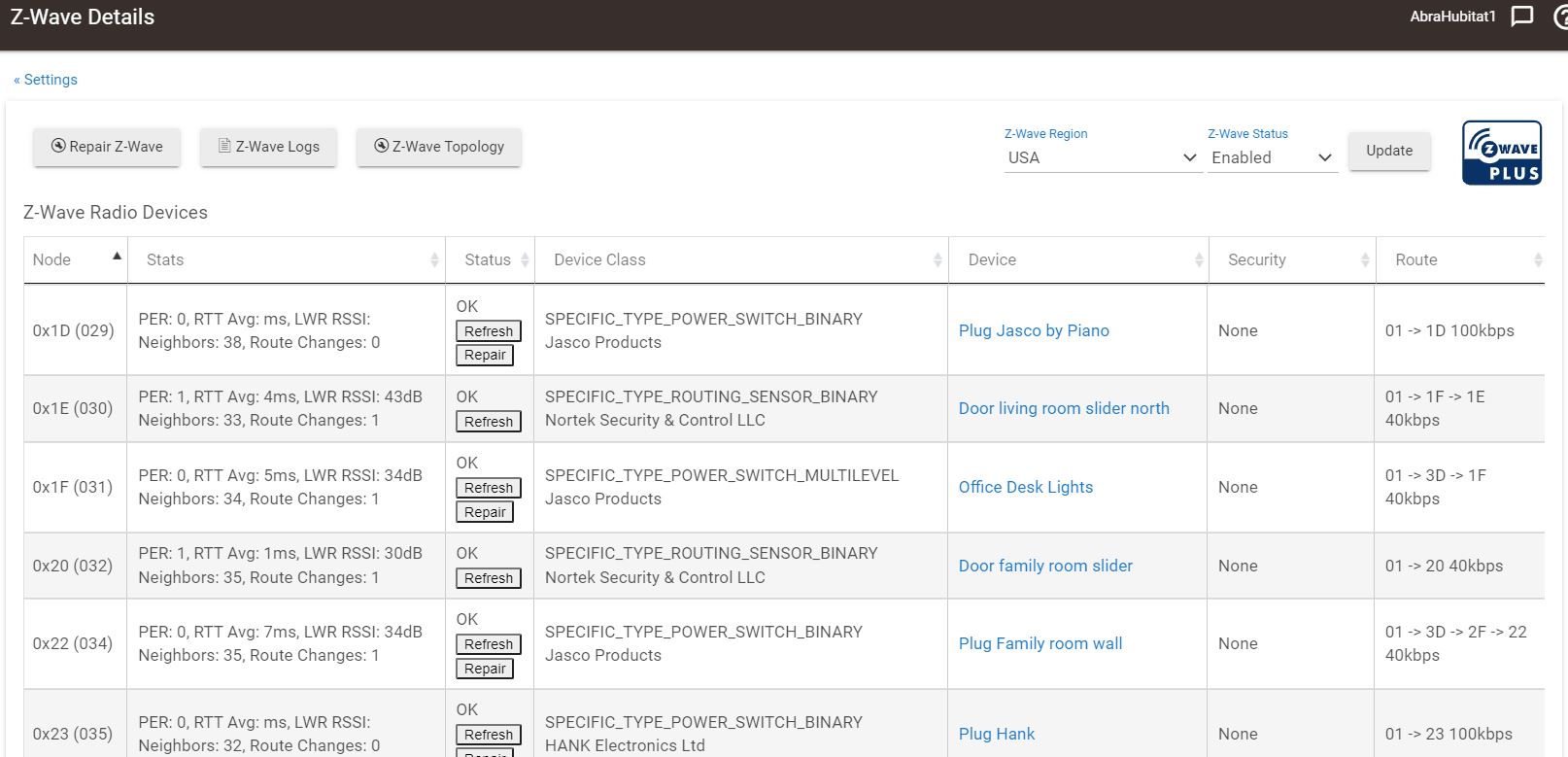

Details page:

Here are details. It's been working fine all week, until this morning. Then again no response on any device for few hours...
It would appear that your z-wave mesh has multiple ghosts.
As @aaiyar mentioned, looks like you have unresponsive devices in your mesh, especially those included with S2 security will create havoc in your mesh. You will need to exclude then reinclude devices and/or add repeaters between your devices and the hub to strengthen your mesh. Check out this document on how to build a strong Z-Wave mesh:

Which are they?
I would guess the ones with no route showing.
