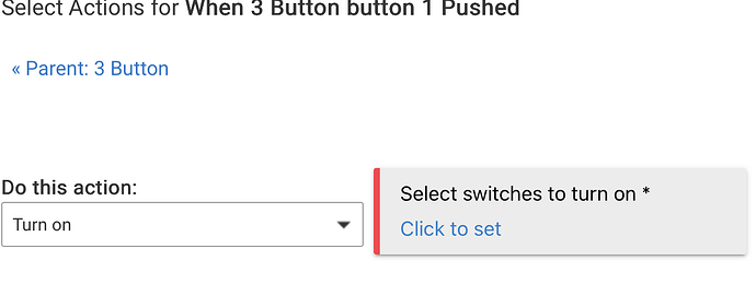

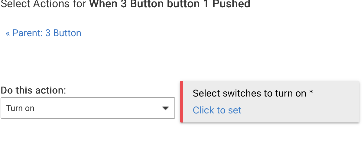

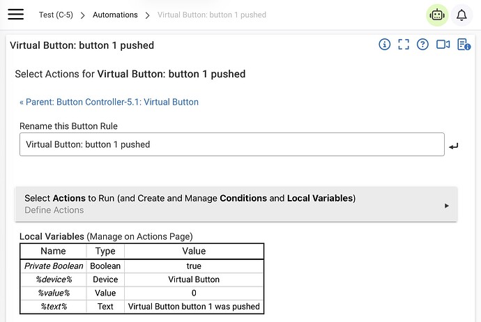

I've attached screenshots. Issue is only (switches) pops up when you try to automate a button controller. Shade is not included as an option under switches.

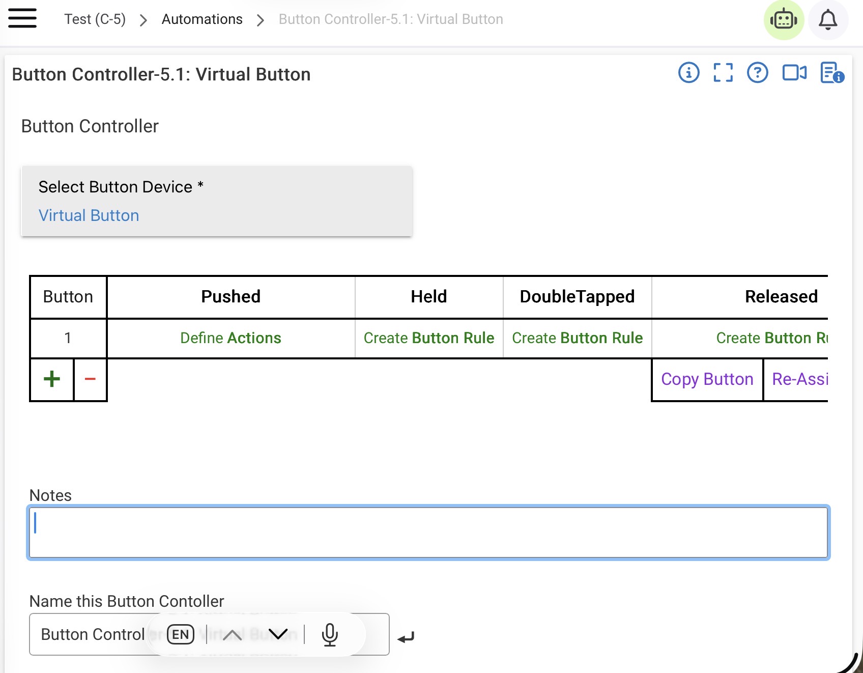

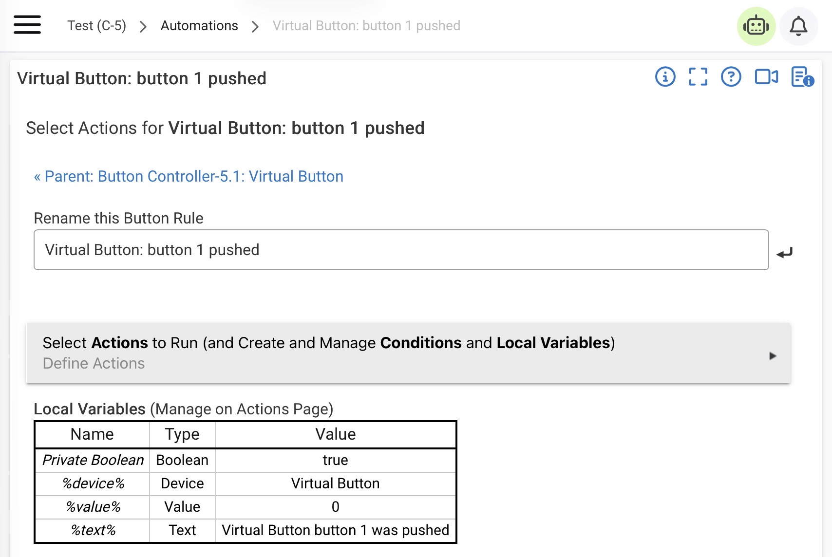

Your button controller is showing different options than mine… Are you using the latest (5.1) version?

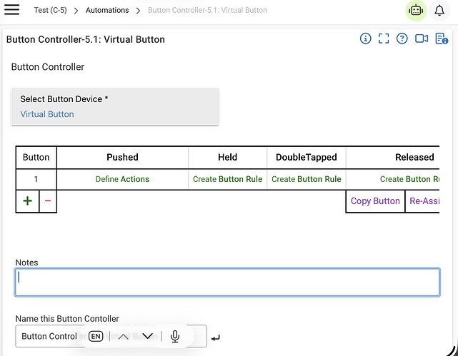

I've been trying to use basic button controller for automation. I have the latest s/w installed but really don't know if it's 5.1. I'll look on the site to figure out how to find the versions. Did you use basic button controller or are you using Rules Machine. I've avoided Rules Machine because it's to hard for me. Based on your screen shots, I just created a virtual button but I'm still stuck since my drop down options don;'t include shade related items.
I just found the automation app called (button controller) and it shows 5.1 like yours. I was using (basic button) version. thanks for the guidance.

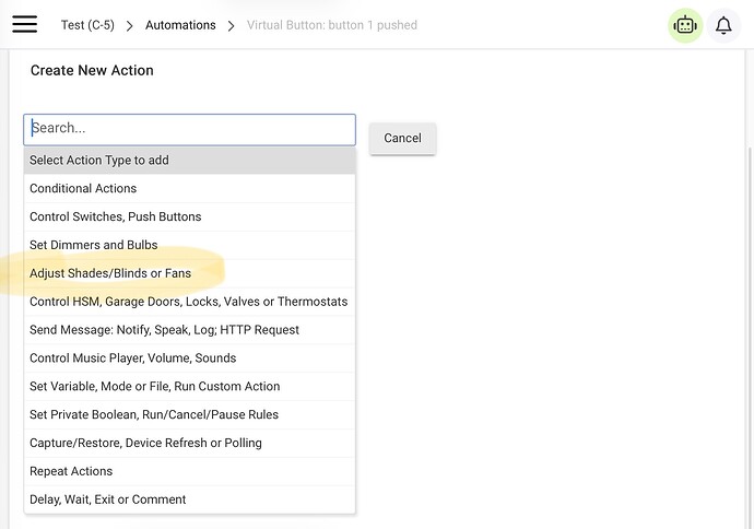

In your screenshot it looks like you’ve already selected the “turn on” action, which is why the UI is only showing you switches. It’s filtering the devices based on the type of action you previously selected.
If you instead select a different action, like adjust shades, that should do what you want.
Adjust shades was never listed as an option because I was using "basic button controller". when I switched to "button controller", then shades became an option. Everything works now. Thanks for reaching out.
