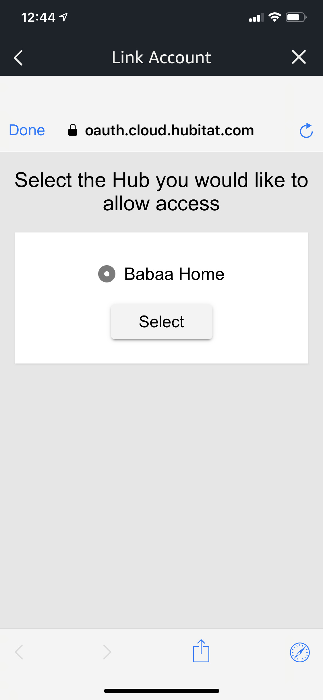

Alexa stopped working after I migrated my login from Amazon to Hubitat and so I removed skill and now cannot add it back..
What happened? How to fix?
Hi there, sorry for the troubles. Your hub appears to be disconnected from the cloud. Please reboot from Settings, then when the hub comes back online, first go to Settings and click "Check for Updates". If your hub is connected, it should prompt you to update to version 2.1.3.125. Perform the update, then try to link the Alexa Skill again.
Bobby, Thank you. That worked.
