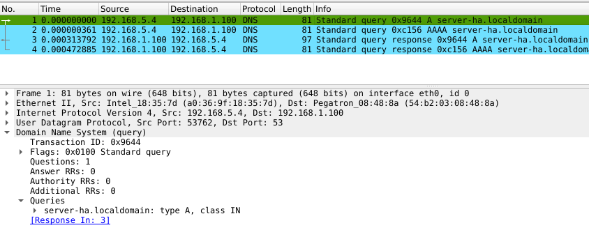

With Wireshark I see that HE issues DNS queries for my automation server pretty regularly every 30 seconds and this should not ever happen because I've put IP addresses, and not host names, into every field that needs it. I first thought that it might be the MQTT app but I checked it, and all apps. Any idea what might be making these queries?

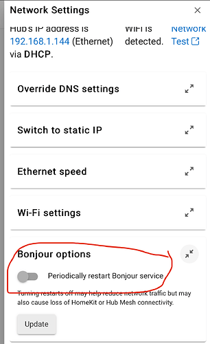

Are these true DNS queries or might they be mDNS queries? If the latter, you might be able to drastically reduce the frequency of those queries by disabling the periodic Bonjour refreshing in the HE hub’s Network settings page.
sounds like mdns queries
I appreciate the advice but...
Yep, that looks like traditional DNS traffic to me. Looks like you might be running multiple VLANs? No idea why that might make a difference, just an observation. Often, multiple VLANs can create additional complexity that can result in 'fun' troubleshooting. I am not recommending you change anything, just an observation. :thinking:
