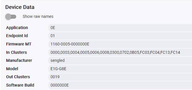

This is the device details from one of the light strips:

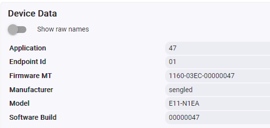

This is the device details from one of the bulbs:
