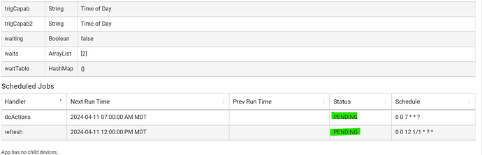

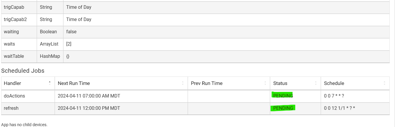

I replaced my Vera controller with Hubitat. The integration went well with all my devices. I created scenes (apps); however, none have run. All show pending. What have I done wrong? Did I miss a step?
Probably not, but it would be easier to say if we knew more about your setup. Can you share a screenshot (or more specific description) of what you have done? Scenes do not run/activate on their own, for example, so there must be something else.

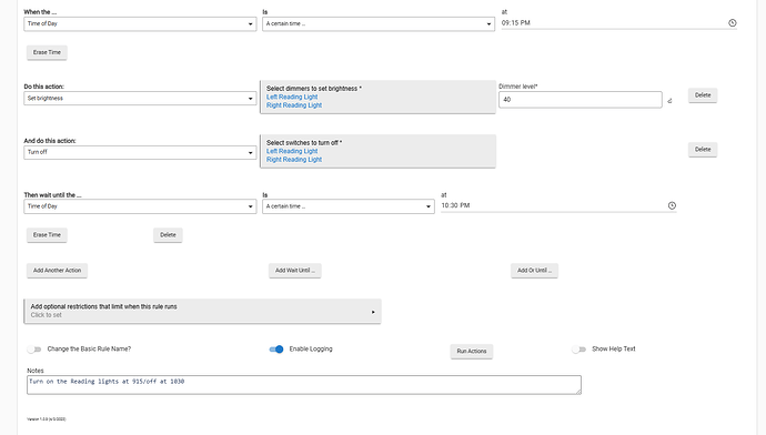

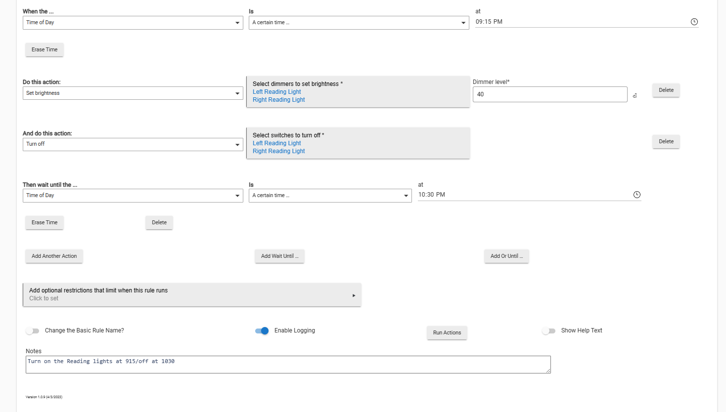

Here is a sample of what I accomplished. At a specific time, turn on the lights, set to 40%, turn off the lights at a time.
I created this under the basic rule. Is that my error?

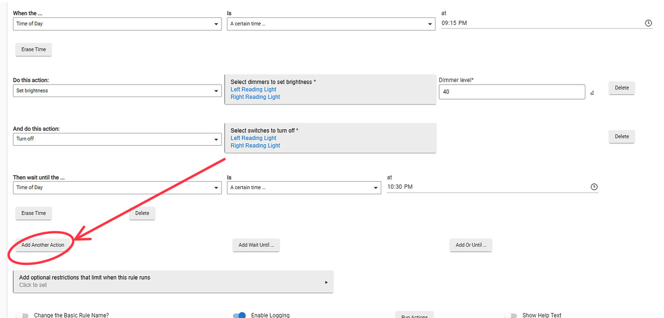

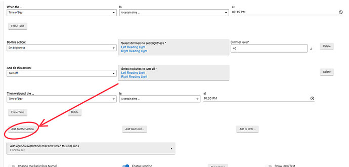

I don’t use Basic Rule but it looks like you are turn on the lights at 9:15 and then immediately turning them off. Then it waits until 10:30 and dose nothing. You can verify this in the logs.
You need to move the turn off after the wait.

Duh - Good catch. I will verify everything else to ensure I did not make the same mistake throughout.
