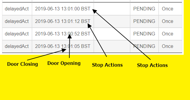

Here are the Scheduled Jobs.
Here is the door opening and closing.

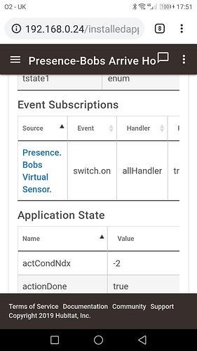

Please look at the Event Subscriptions on the app status page. Same for @spalexander68 and @CAZ.
This will reveal the following critical information: While the wait is pending, what is the event subscription and is it correct. After the wait has been fulfilled, is that subscription gone. These two facts will reveal what I need to know about your case.
Here you go.
Man, you make this so difficult!
Is that what it was supposed to be waiting for? Were you using Wait for Event or Wait for Condition? What happened? Which state is this: waiting, or after wait is over?
Don't know if this is what you are requesting:

You asked-
Is this not the app status page? When I scroll down I find the Event Subscriptions.
