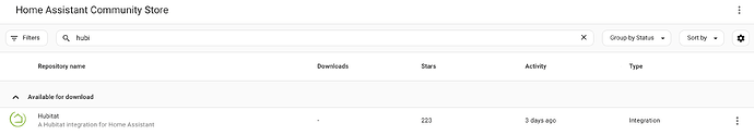

Have you considered using @jason0x43's Hubitat integration that is in HACS?
hi, thx for the quick reply.
This did not came up in my research and i think this is because use the marker API.
I m looking for an event based integration (not point to point), will have other publishers than Hubitat as well as other subscribers than Home assistant.
