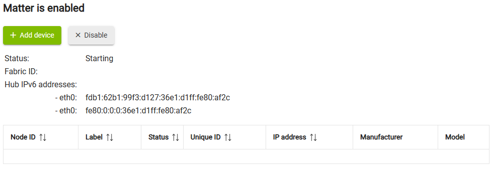

Matter support refuses to start on my C-7 hub. I cannot seem to find any logs that are directly related to Matter, so the best I can do is list the troubleshooting steps I've tried up to this point. Any help in pointing me in the right direction would be greatly appreciated!

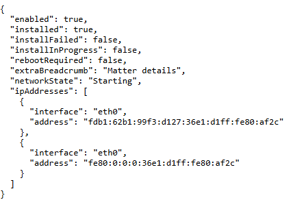

Hmmm, wonder if it is just a UI issue. Can you run:
http://<yourHubIP>/hub/matterDetails/json
and see what the Network State value is?
Thanks for the response! The network state here is "Starting" as well.

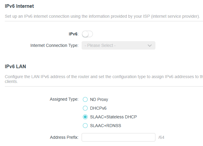

I'm reading that Matter relies on IPv6. Should my router be using a different type? The default is currently selected.

  • On the router: Enabled IPv6 support for the internet connection and tried both DHCPv6 and SLAAC+Stateless DHCP for IPv6 LAN

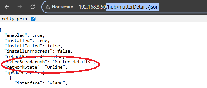

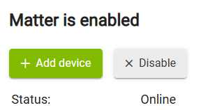

I don't know if it's related to the OP's issue, but my C7 which has been running Matter went into a 'starting' status some time yesterday. I disabled it and re-enabled it and it came back. I think I recall this may have happened once before since I started running Matter on this hub a few weeks ago.
I just added an Uptime Kuma monitor using that endpoint to notify me if the status changes to anything other than 'Online'. Thanks @thebearmay for posting the URL.
AFAIK from previous discussions here you don't need to mess with/configure IPV6 support on your router to use Matter. @aaiyar can likely confirm.
Can confirm that I have IPv6 disabled on my router and my matter devices happily manage to run IPv6 on my network. My matter over WiFi devices all have an IPv4 address on the router, but an IPv6 address on the hub.
Same on my end...

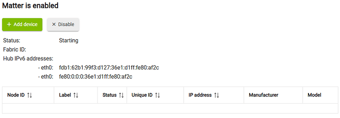

Thanks for the suggestion! I hadn't come across that, but I did just try it, with no luck. For kicks, I also:
  • Disabled Matter
  • Restarted the hub (rebuilding the database/clearing old logs)
  • Enabled Matter
  • Reset Matter (again)
