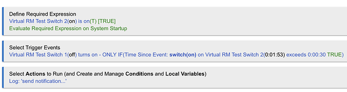

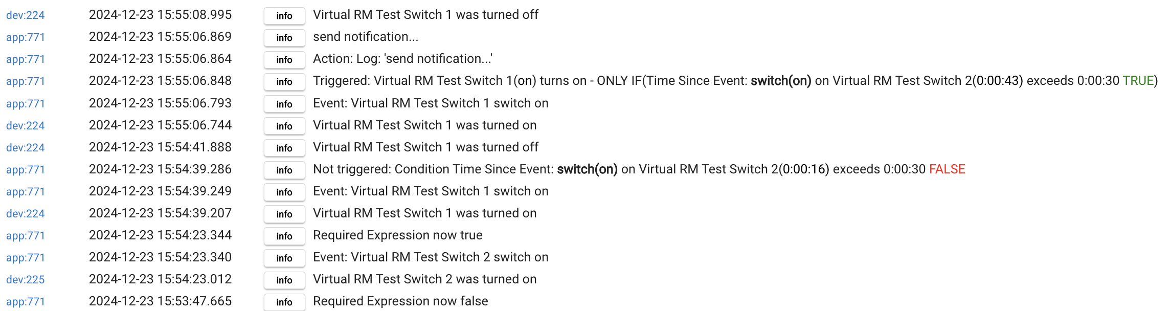

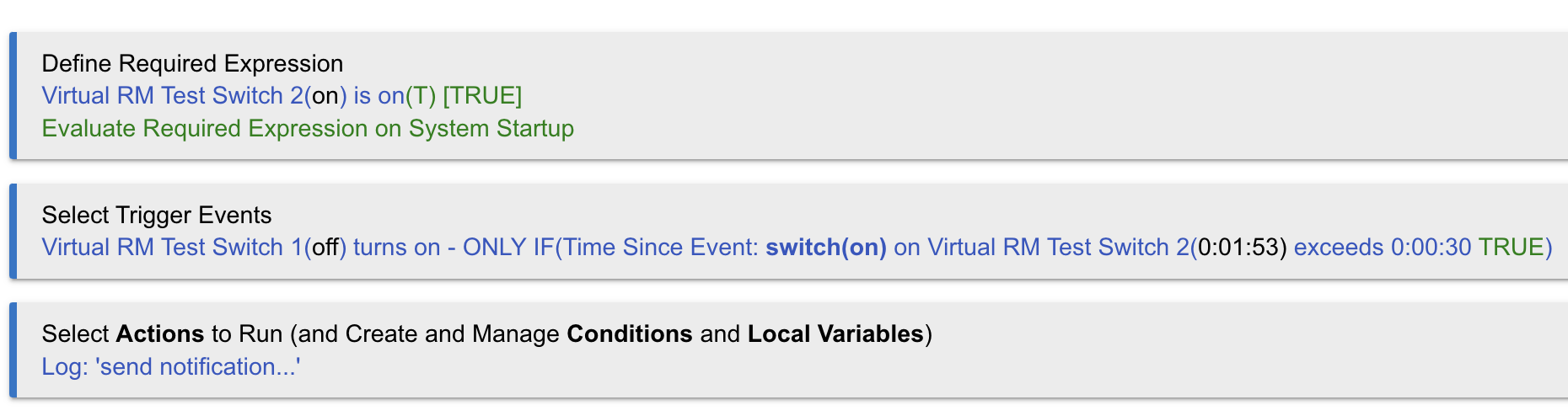

I think I know what piece you might have been missing using Time since event. Searching for the last "on" event doesn't tell you that the switch is actually currently "on" - there could have been a subsequent "off" event. Here's how to put it all together (using 30 seconds for the purpose of this test) :
