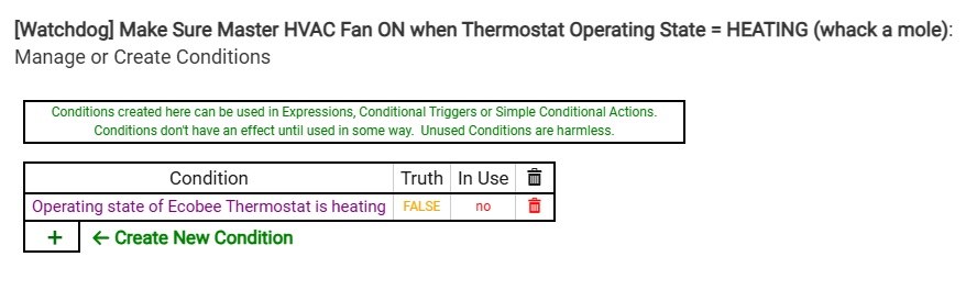

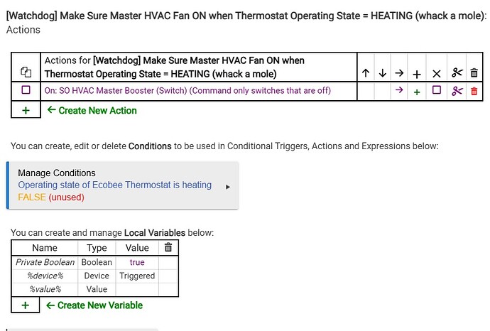

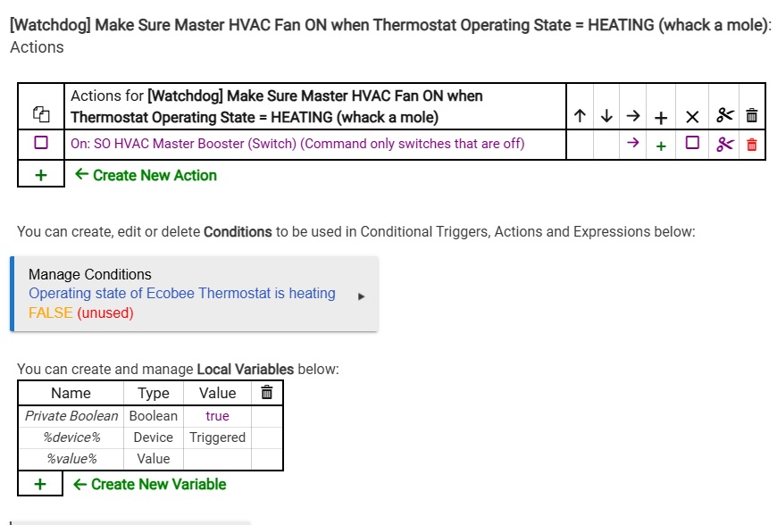

It says (unused) on the Condition. It's defined but not enabled.
You are correct. Thank you or pointing this out!
Ive never changed that setting and dont know how to put it back into use.

Very top of the rule there is a toggle to 'Use Required Expression' toggle that back on. It must have been active and then got toggled off somehow.
I went back and looked at my other rule and Use Required Expression is OFF but the CONDITION is In Use. Toggling that setting doesnt solve the make the CONDITION turn to in use. I think I will just delete and recreate the rule to see if I can fix it. Its not too complex. Will report back.

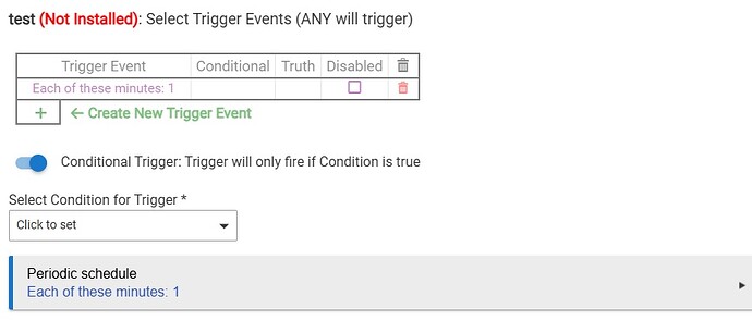

OK so I recreated the rule from scratch and made sure to toggle "Conditional Trigger" when adding the trigger. I have no idea how my rule got changed nor why you would create a condition that wouldnt be used.
Anyway, its fixed. Thanks so much for your help!!!
