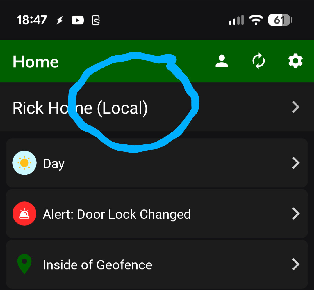

Can you confirm that the app says local as shown in the screen capture?

Can you confirm that the app says local as shown in the screen capture? No, it does not say, "Local". I can't even get to that page in the app. It spins and eventually goes to a "Select a hub" page which is not functional.

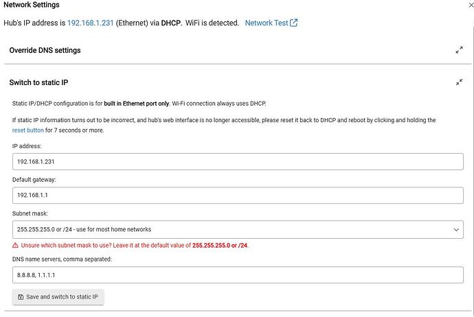

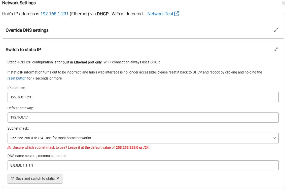

Thank you for the trouble-shooting. I also think this is a bad configuration - it is possible that hub is flipping between wired and wireless networks.
The hub is NOT connected to wifi, only Ethernet (always has been). I only switched to a static IP because of this issue. It was occurring BEFORE I made these configuration changes by choosing a static IP and default gateway. After doing the reset (pressing for 7 seconds), the hub rebooted, but still shows the same configuration on the Static IP fields (it did not wipe the fields clean...was it supposed to?). I will see again if the issue happens tonight. FYI, this morning, again, the hub had local web interface control, but no cloud connection, and the app was inoperable.
No, the hub is not nor has ever been connected via wifi, only wired Ethernet.

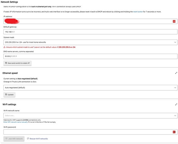

You clipped off the top of your screen capture.

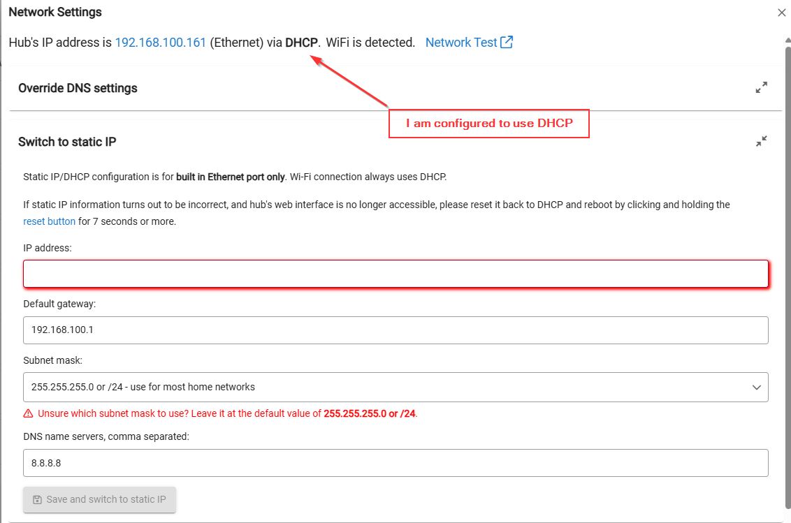

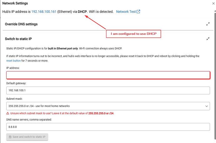

Can you confirm if you are currently using Static or DHCP (see my example). Also you don't have to mask your local IP address. It would be useful to see that value to confirm you have assigned a proper address for your network.
If you confirm that you are using DHCP, and the "every night" problem just started with the new router, it may be because of the DHCP lease expiry timer.

Yes, my router is not new, but my Hubitat is. Yesterday I did a soft reset hoping it would clean out any infected code, etc. But the hub disconnected from the cloud overnight anyway. I'm only tech-savvy enough to be dangerous, so I appreciate your help. I am new to the Hubitat world, but my network, pre-Hubitat, has always been stable. I switched the hub setting to static IP several days ago, hoping it would solve the problem, but it did not solve it. Aside from this screenshot, I'll post a couple from my router for you to see if there is anything amiss.
