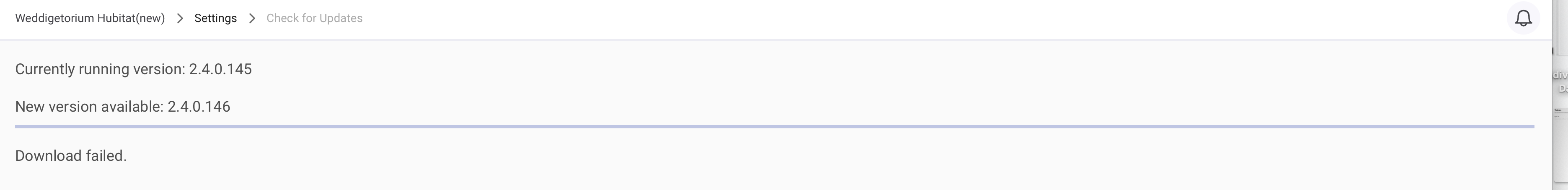

I installed .145 yesterday with no issues. I didn't get a notification there was a new update, but when I went to Settings and checked for updates I saw there was .146. I've tried to upgrade to .146 but each time after it get to the 70 something % it then jumps to saying it is verifying the download and then I get a message the download failed, but the blue line between the New version available and the Download failed message keeps moving. This has happened 3 times now.
What do I need to do?

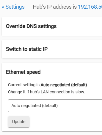

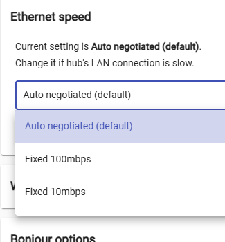

Change network settings from auto to 100 or if its 100 to auto ..
It was at 100 and I changed it to auto and that worked. Thanks!
