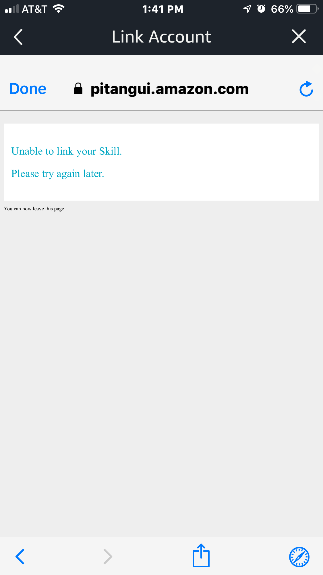

[SOLVED] Can’t enable Hubitat Alexa Skill
“Unable to link your Skill.
Please try again later.”
Disabled the skill in Alexa, removed all HE devices from Alexa, removed Alexa App from HE (the skill one).
Then, added the HE App, selected just one switch and then went to Alexa to enable skill and it got me that error message.
Will try again soon...

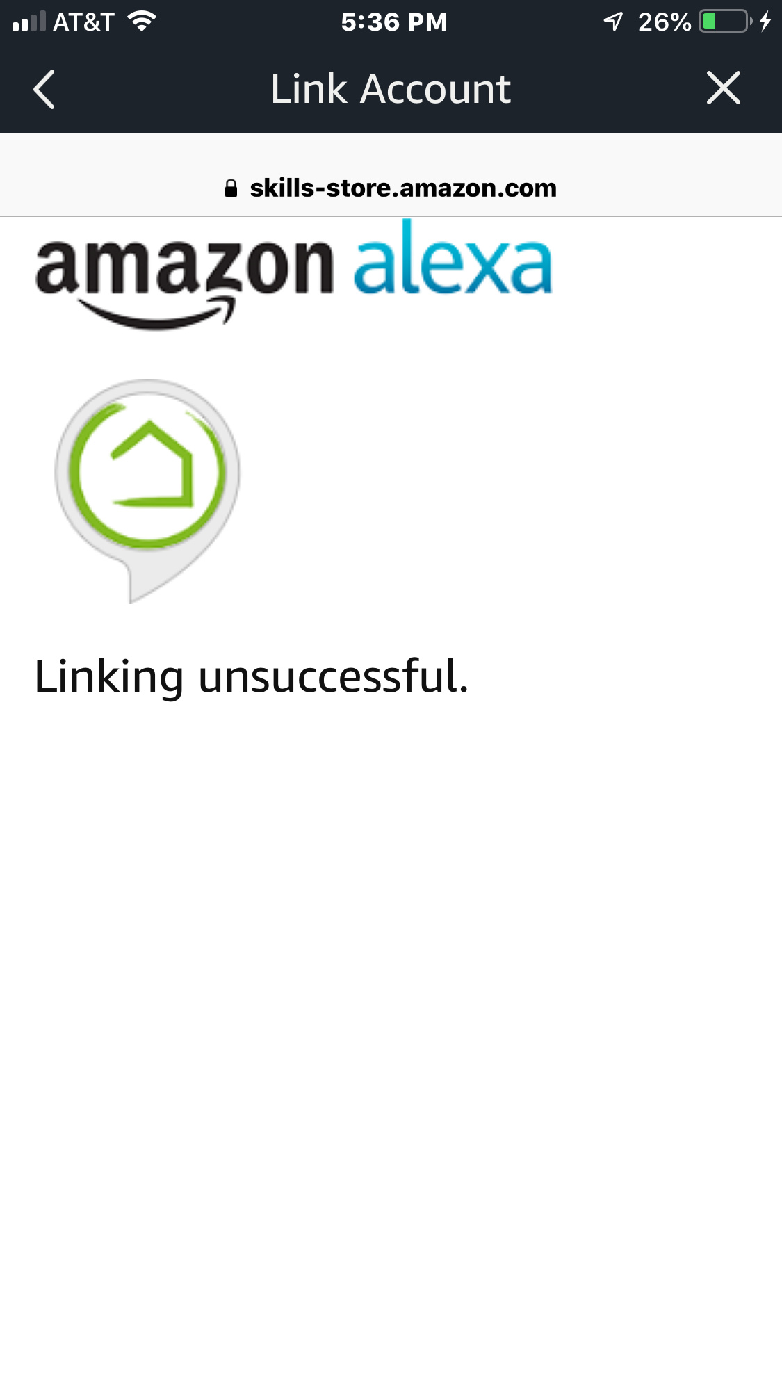

I'm having this same problem, and shutting the hub down didn't seem to fix it. The skill was working successfully for me for some time, and then just stopped working today. I tried to disable and re-link to fix it, and get the linking unsuccessful error each time. Any other ideas besides shutting down? Has anything changed in the last 3 years that would affect how this works?
Thanks!
Right now AWS is experiencing "issues"...
Thanks - good to hear it's not just me.
This is so frustrating. Do we know is Amazon is doing anything about this
According to their support, they are doing everything they can, but there is no ETA when it will be resolved.
