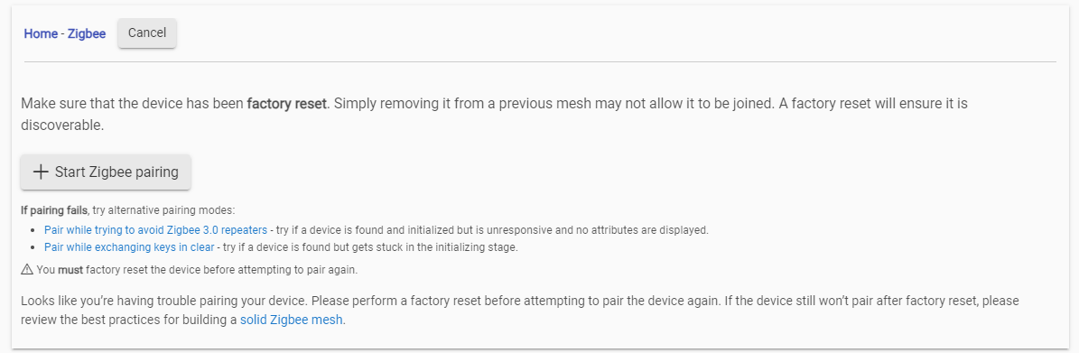

I tried pairing two different models of bulbs and it is unable to find either and nothing pops up when I click "Start Pairing".
I've tried to add the device manually through Zigbee and also through Find by device type.

I looked under Zigbee details and it says, "Zigbee is enabled and is in join mode".

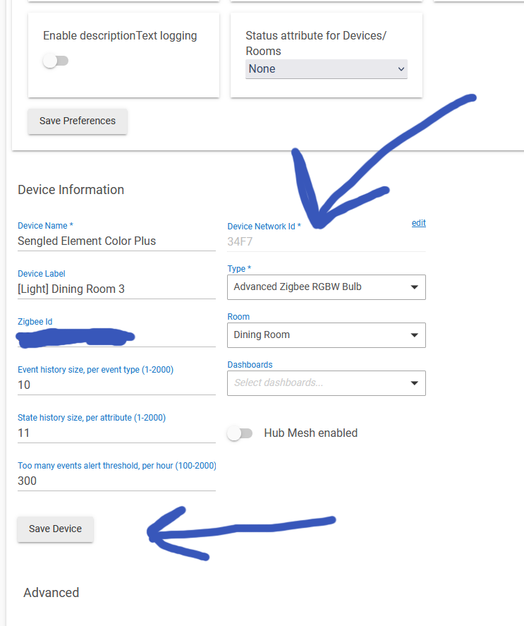

Pardon me for being new, but where would I find the "Advanced Zigbee RGBW Bulb driver"?
I'd be happy to give it a try.

Its in the device page itself. After you change and save device after that then click configure in the device page. The bulb will go through a thing and end up blue. Then it is ready to use.
