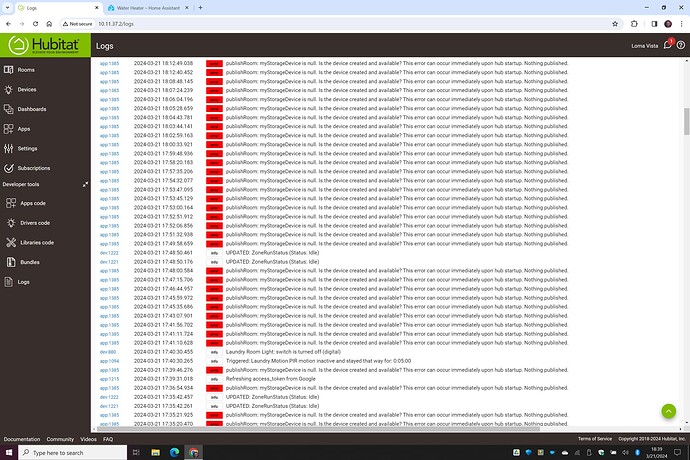

(SOLVED) [2.3.8.128 - C-5] All the sudden randomly started getting tons of errors in logs
What the heck is all this? Just started today at 7:25AM randomly and has sporatically occurred again several times throughout the day. No idea what causes this as I have been away for over a week and nothing has changed on Hubitat as far as I am aware..
What is app 1385?
That app seems to correspond to "Living Room"
I have no app called "Living Room" so I am assuming this has something to do with Rooms within Hubitat, because I do have a Room called Living Room.
But Hubitat itself was updated a few days ago to from 2.3.8.125 to .128, but these errors just started happening randomly today and I haven't even been home to mess things up.
I figured it out. I accidentally disabled an app (Tile Builder) and I guess I had previously been working on a Tile Builder room dashboard and this child app freaked out when the parent app was accidentally disabled. Not sure how I did that.....
