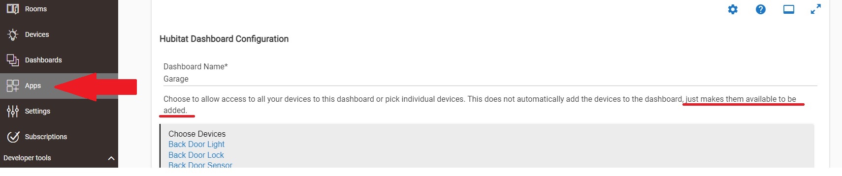

Steps
1: Open web browser and Go to yourhubip.
2: On the left hand side, click on Apps
3: Scroll down to Hubitat Dashboard
4: Click on the dashboard your want to add devices to. In my case I'll click on kiosk
5: Click on Choose devices
6: Scroll with mouse wheel and click device(s) you want to add to that particular dashboard
7: Click Update
8: Click Done
9: Click Dashboards on the left hand side and pick the dashboard you want (In my case kisosk)
10: Click + symbol in upper right hand corner . Left column device you want (the new devices) Right hand column Battery.
11: Click Add Tile
Result (I added the Tuya 4-in-1 battery to this dash)
The key phrase is here:
The inverse of this statement is also true. If you don't select the devices in this menu, they aren't available in a particular dashboard. Follow rlithgow's steps above to get to this menu.
Also, the first few steps in the Documentation cover adding devices. They are creating a new dashboard in the documentation, but the steps are similar once you are in the Dashboard app. Hubitat® Dashboard | Hubitat Documentation

From your last post with screenshots, if you look to the left of the list of apps to install, the Hubitat Dashboard App is display just next to the Life 360 Connector app in the install list.
There is a link to the parent dashboard app, but also the individual dashboards, which it where you configure the devices, as others have explained

you don't need to reinstall, simply go to apps, hubitat dashboard and pick the dashboard.
Have you tried clicking on the link I pointed out in my last post?
