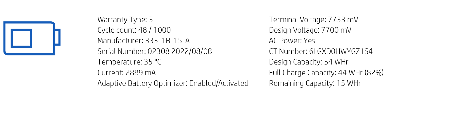

the laptop still will say its charging to 100% but if you check the battery diagnostics it is really only charging to like 80% of capacity..

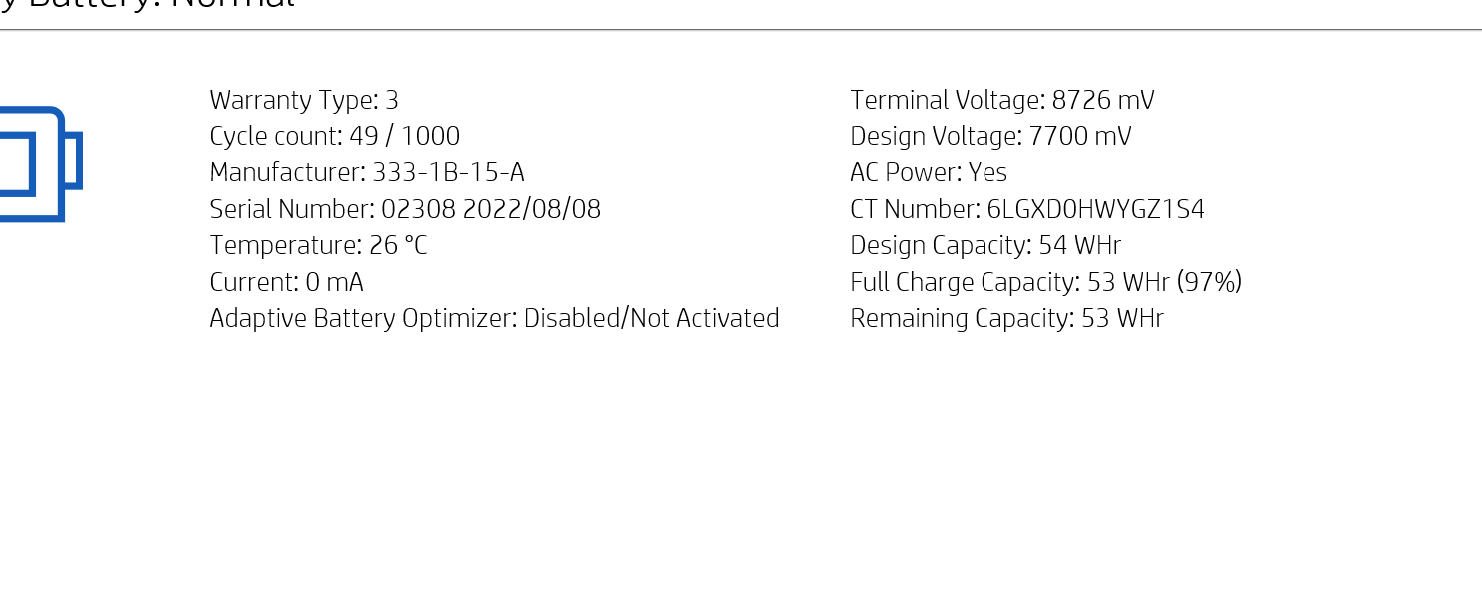

ie
before
after

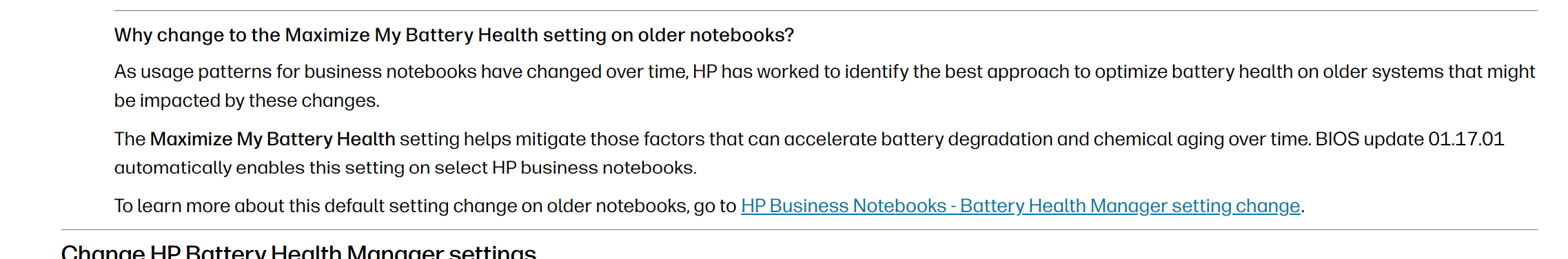

https://support.hp.com/us-en/document/ish_4449597-3519507-16
