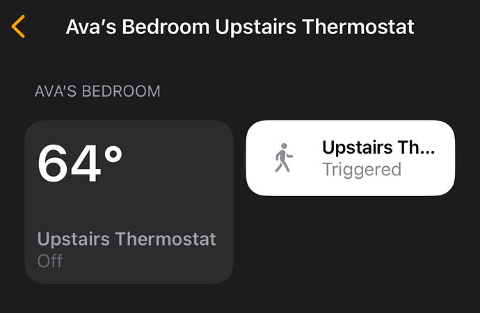

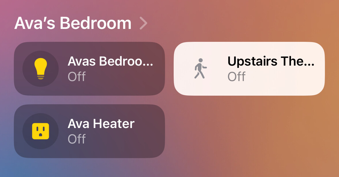

When I connect the sensor to Homebridge, it shows up in HomeKit just fine, but the device has two accessories attached.
My main question is that I would like HomeKit to show the main thermostat instead of the room occupation sensor on the homepage. Is that even possible?
Ideally, I don't have any need for the motion sensor, but I'm not seeing any way to deactivate that or split apart the device into a separate thermostat and sensor.

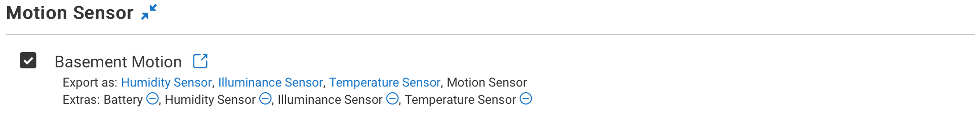

Inside the HomeKit Integration app you can select which additional properties are reported:

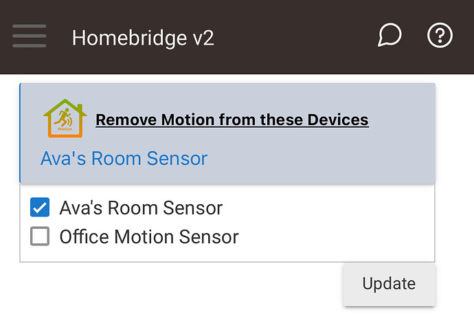

Is this what you are referring to? The filtering in the Hubitat Homebridge app?
I did that about 10 minutes ago and restarted, but the motion sensing is still there. Maybe it takes a little time.
I was referring to the built in Home kit integration, but that should work. Should reflect the change on the next poll/refresh.
