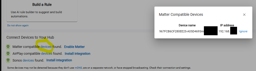

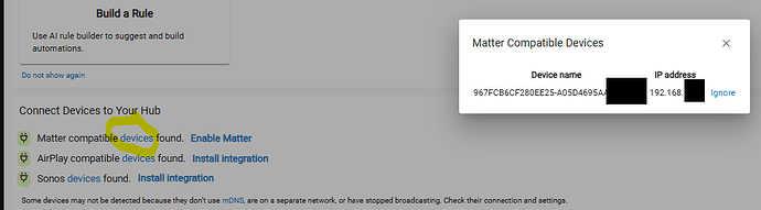

Home tab:
The listed IP address is the address for my ST Hub.
I can see the IP address of my ST hub as well.... :thinking: It seems like a bug in HE.

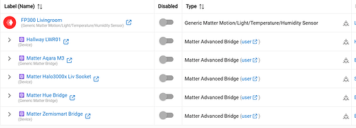

I am not sure that I understand. My matter devices in hubitat are coming from my smartthings hub. Does that not make it a matter bridge?
Not necessarily. If the devices are already Matter devices, SmartThings is just another Matter controller sharing them with Hubitat. It would only be a Matter bridge if SmartThings were exposing non-Matter SmartThings devices, like Zigbee/Z-Wave devices, to Hubitat as Matter devices.

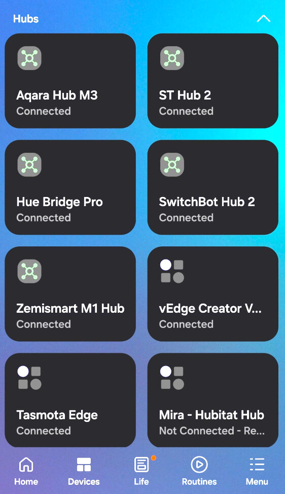

I see that you have an aqara m3 hub. So that would let me bring in any aqara device that is connected to it without a hubitat specific driver?
Sorry, if this is creating a tangent.
Yes, SmartThings hub is acting as a Matter controller and can share native Matter devices via multi-admin, that's why I have several matter devices and hubs connected to it.
You cannot add SmartThings to Hubitat as a Matter bridge.
Yes, probably a bug in Hubitat. Alexa/SmartThings are Matter-capable hubs/controllers.

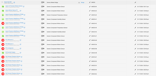

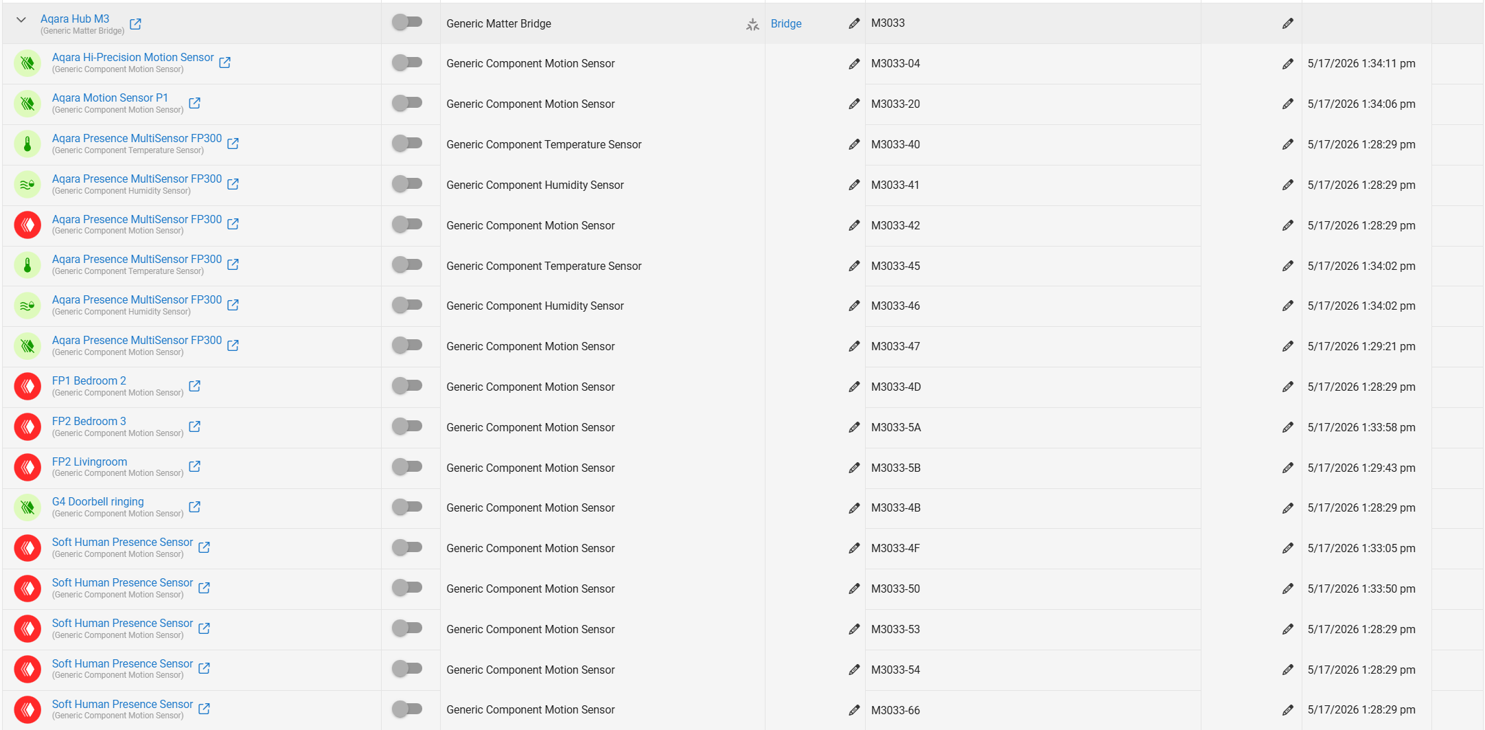

Yes, you can bring Aqara M3 child devices into Hubitat via Matter - this is a real bridge use case.
Just add as a Matter device in Hubitat, and Hubitat built-in "Generic Matter Bridge" driver will pick it up (I am currently using the custom community driver as per my previous post), see below on my test hub:

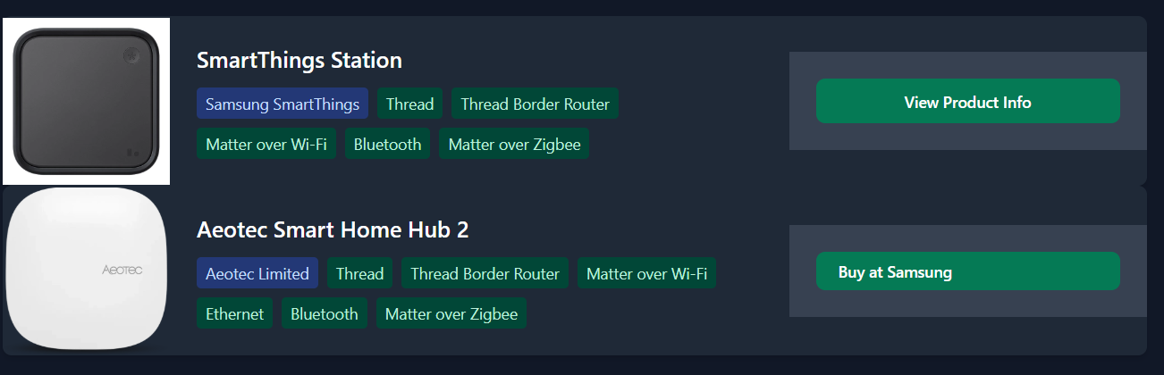

I am not a Matter/Thread expert by any means, but I think your statement that SmartThing hubs are note Matter Bridges is a bit incorrect. The original ST hubs are not, but the the Aeotec Gen 2 hub is a Thread Border Router, as is the SmartThings Station (which may now be discontinued?) [ Thread Border Routers: The complete list of what you can buy today | Matter Alpha]
